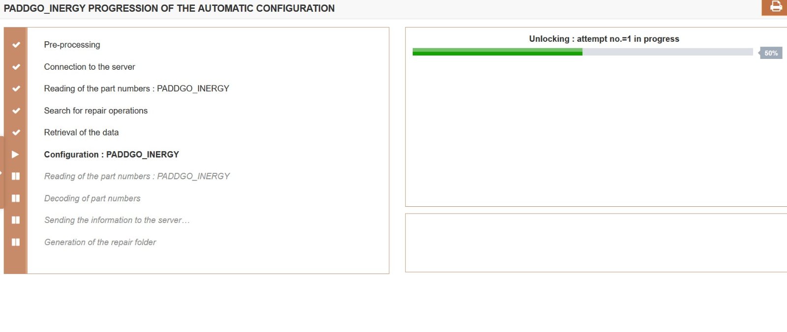

New tank with pump for urea changed. Tap full with urea.
Diagbox v9.103, connected to Citroen servers.
Pump and tank Paddgo Inergy, without bag, tank with urea.
I cant change capacity of tapped urea, software always show 0.00 lit.
Any idea?
Any idea?

Thank you for your answer.
My C4 have not Adblue tank, onlly tank for urea, without bag. I fill tank with 1 lit. of urea.
Yes, I purchased token from Citroen.
Tank with pump is produced by Paddgo Inergy, and pump inside old one tank is out of order.
In meny I select 0.96l of urea and programm it , but reading status of tank Diagbog show that tank is empty.
Tank is autoconfigured by Citroen server.
There is menu cofiguration for Urea additive also in ECU submenu.
As last solution I will contact dealer.
Sorry for my bad English.

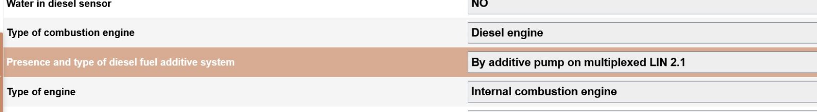

I put Eolys in the DPF tank! I have not Adblue tank.
Tank is under car, behind the left wheel. Manufacturer Paddgo , electronic pump Magneti marreli.
3 pin connector, 12V a LIN communication.

Ok so your vehicle was built in Feb 2015 and is a Euro 5 and has DPF only, so NO SCR system.
That is why we were confused as you were talking about UREA
Now if you have replaced the additive tank with a new one, then you should refill it with 3 litres of additive.
You only use 1lt kits for topping up during mid-life.
The fuel circuit has to be primed and you reset the additive ECU to zero.
What you are doing above looks like you are initialising the additive ECU. This is not where you reset the additive counter.
You need to locate the function (usually in the engine ECU menu - or in the additive ECU menu) and choose the option to reset the fuel additive counter, then prime the fuel circuit using the engine ECU menu.

pavlebo
- Posts: 44
- Joined: 23 May 2010, 09:47
- x 2
Re: C4 Picasso B78 2015 additive tank Paddgo without bag
The procedure I used.
- x 6947
Yes, that's correct.
