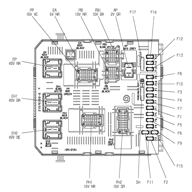

Apart from that the front cigar lighter is fuse F9 in the BSI

Post by mrarg1393 »
Just checked that and replaced it just in case but still nothing. I have no idea why it’s not working then… must be faulty wiring/connector to the actual socket possibly?
