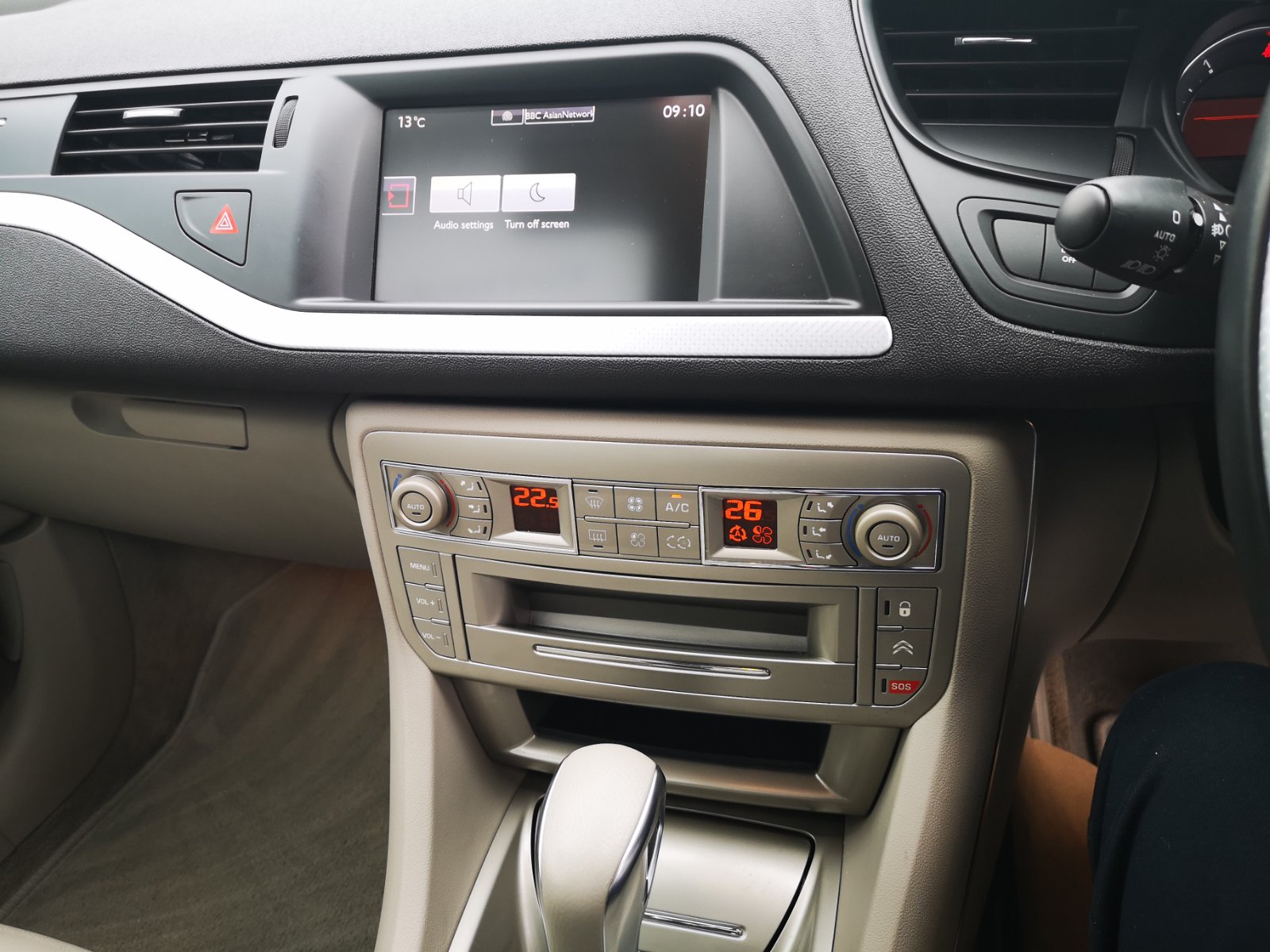

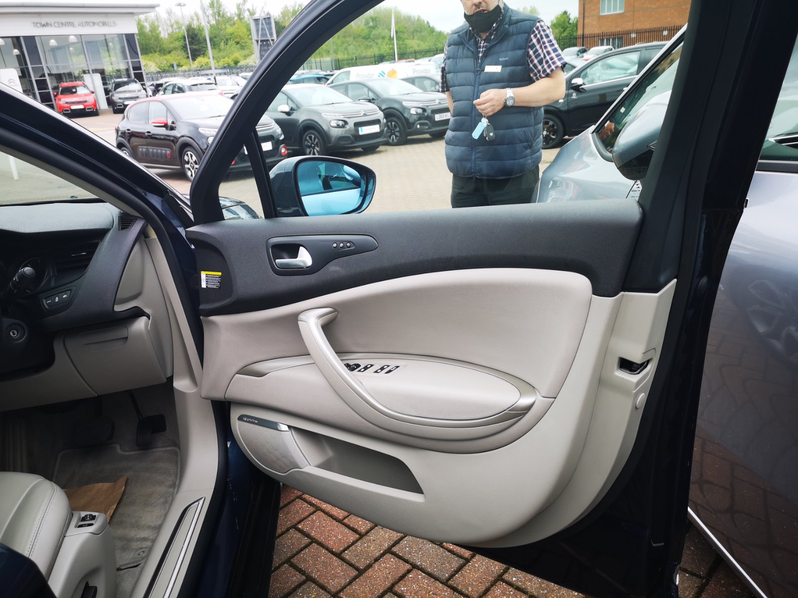

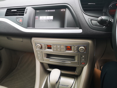

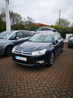

Have taken the car in for the repair today and I thought I'd take a couple of pictures of their own C5 Tourer.
It's amazing and has every possible extra. It also has a digital satnav/radio unlike mine with the old MWay.
There's a good deal of interest so I think it's a matter of first to see it will buy.
As I said, this isn't any promotion on behalf of them but just something the forum members may well want to take up The company again is Town Centre Citroen in Sunderland
