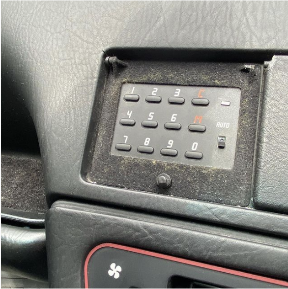

Help! - I have just bought a 1989 CX 25 GTI Turbo 2 (a month or so ago) – and my son was playing with the immobiliser key pad – and has managed to now immobilise the car! – The previous owner has no idea what the code is, and actually assumed that it was disconnected. Has anybody got any idea on what I can do, so that I can reset it, and start the car?!

My guess is that the immobiliser was disabled. I think that this was possible on the CX and early XM by setting the code to 0000.
If your son has managed to set a new code, then the only approved way to unlock it is to type in the same code.
If that is not possible, then you will have to get the immobiliser reprogrammed by having the memory chip removed from the ECU and reprogrammed to a known code. The trick is finding someone who is familiar with the ECU who can do it. Or find a replacement ECU with known code.
