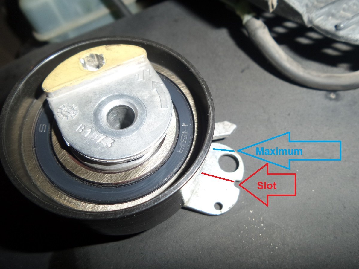

Hi everyone,

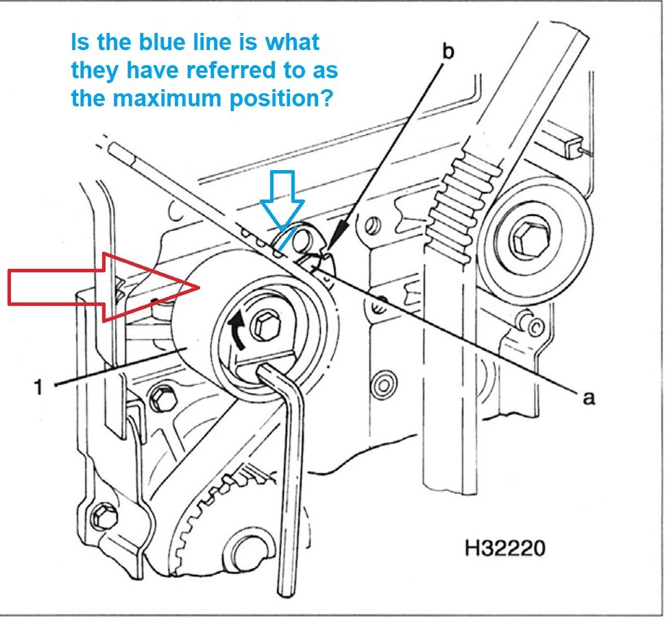

I want to adjust the tension of my new timing belt. I found instructions in Haynes about automatic belt tensioner but there are some parts of it that I'm not sure of.
In the following picture (red paragraph), it is said that index pointer should first be set in its maximum position.
Then, in the next page it is said that after cranking the engine, you have to set the index pointer aligned with the slot in the center.
The slot is shown in the picture and it is quite clear but I'm not sure about what is meant by maximum position.
I have specified what I guess in the following pictures.
Correct me if I'm wrong.
Thanks in advance.

I think it will be the other way around, i.e. turning the tensioner fully clockwise to get max tension on the belt. It will be obvious once you get it on the car, as one way will make the belt tight and the other won't!

RichardW wrote: 20 May 2021, 07:18 I think it will be the other way around, i.e. turning the tensioner fully clockwise to get max tension on the belt. It will be obvious once you get it on the car, as one way will make the belt tight and the other won't!
So, my guess was right! Thanks a million for your assurance.
