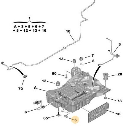

I take it that means you don't know there is a drain plug on the urea tank? (number 5)![]()
You just undo a small torx screw then the plug just twists out. I wouldn't fancy getting a mouth full of urea
