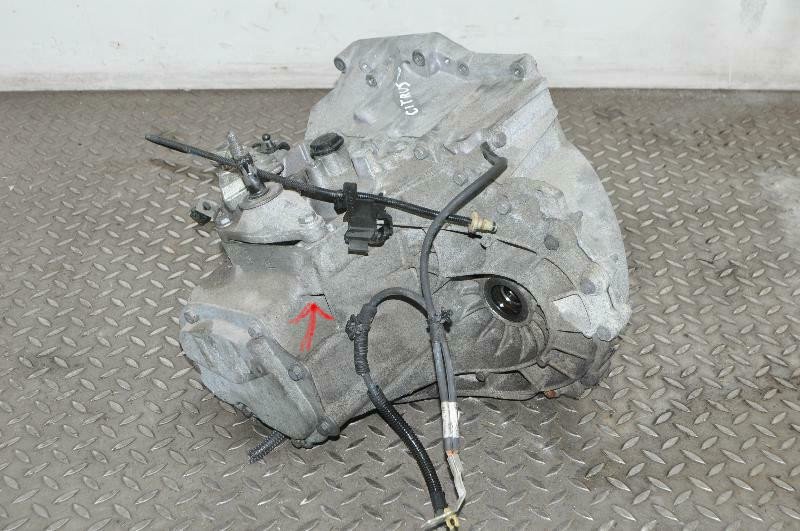

Hi, whilst changing the brake pads on my daughters ds4 I noticed a small leak and tracked it to a small hole about 5mm perfect circle inside the area arrowed in pic. it is on the roof of that section should it be there? or should there be a plug of some kind in it, or its it damaged some how? (not actually gearbox) thanks in advance.

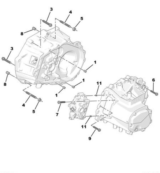

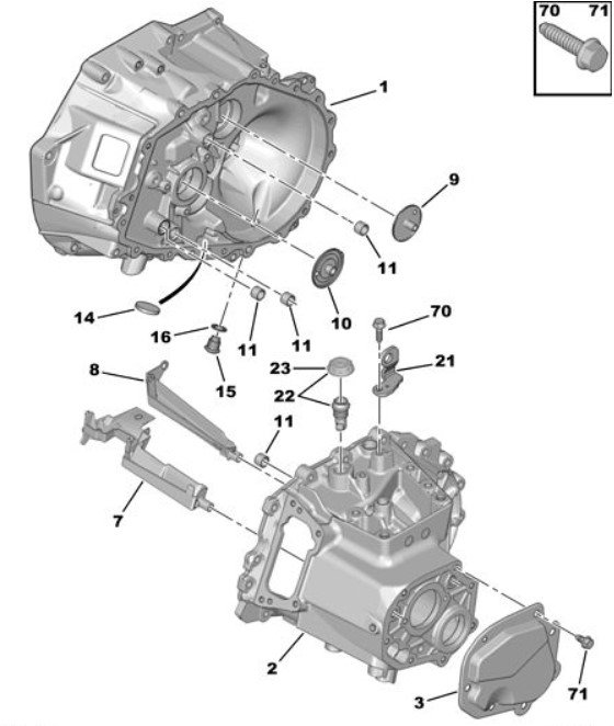

Can you identify anything from these diagrams?
r3ynolds
Posts: 7
Joined: 28 Dec 2020, 20:54
Re: ds4 gearbox oil leak from small hole
Unread post by r3ynolds »
Thanks for diagrams. no nothing on them indicate what the hole could be. the car will be at mine tomorrow so ill try getting a clear pic then.

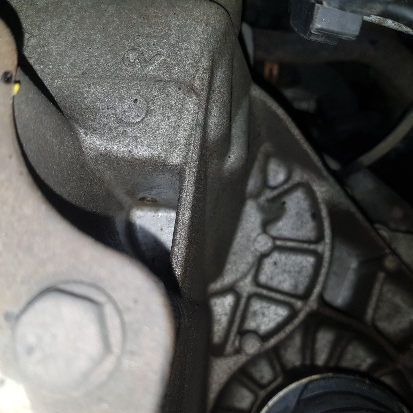

r3ynolds
Posts: 7
heres a pic of the hole. yes Dormouse there is a bolt direct above it for engine mount. this is def where the oil is coming from as there was a trail from it when i first look.
