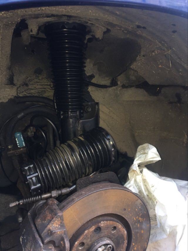

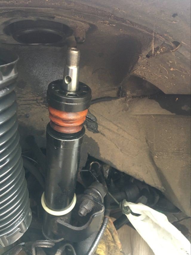

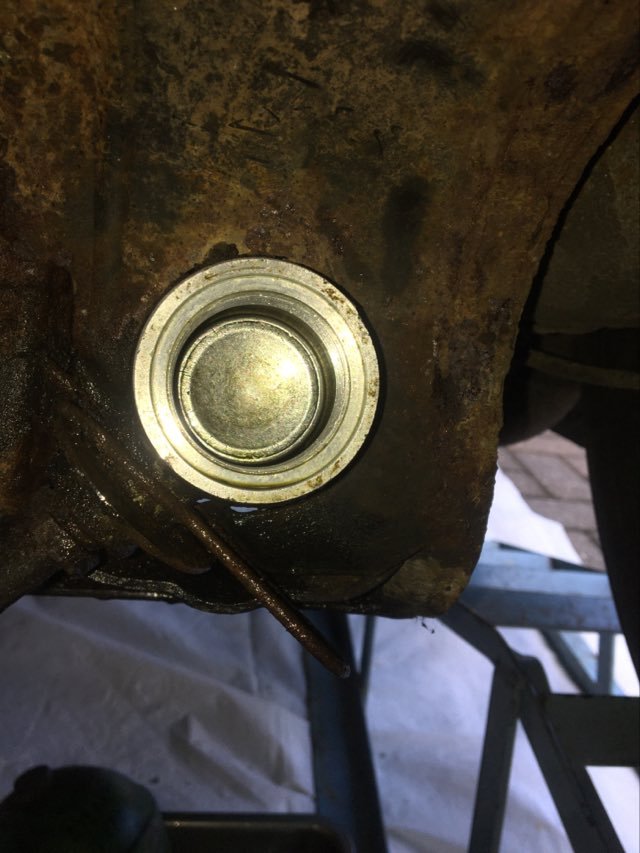

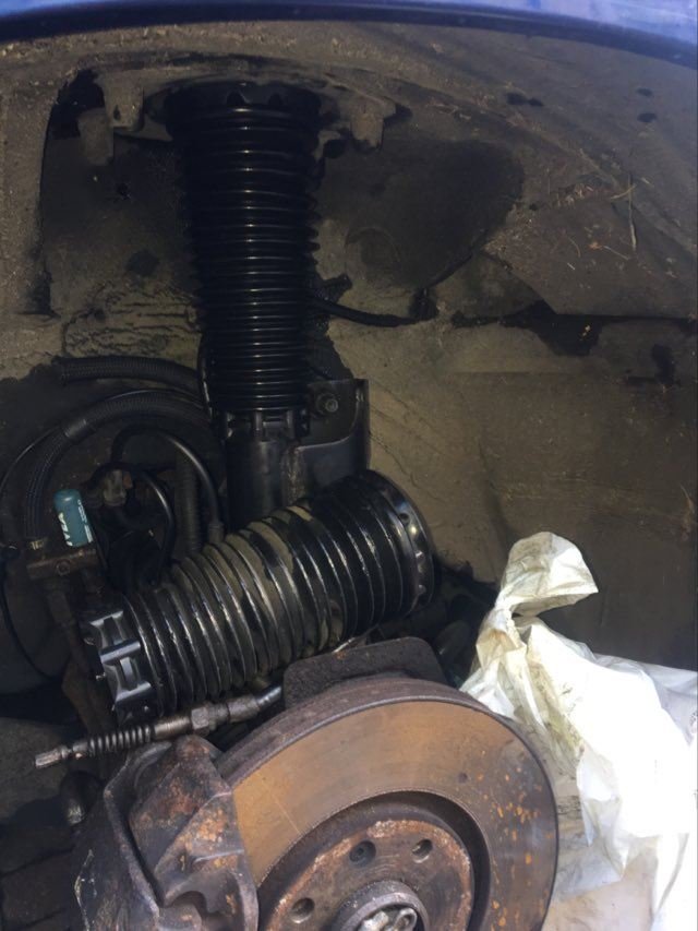

Well an overnight bath of penetrating fluid had no real effect and after much hammering and twisting there was no movement at all #-o
In desperation I removed the sphere which released a small amount of LHM+ fluid but nothing to suggest there was any pressure left in the system BUT shortly after I thought I saw the nut drop down to the unit, it had released itself with hardly any effort from a solid grip like some sort of gravity Ninja :shock:
So somewhere / somehow / something was affected which altered the struts attitude ... vacumn :?:
Skull's strut removed by some Ninja skills
No corrosion on strut :?:

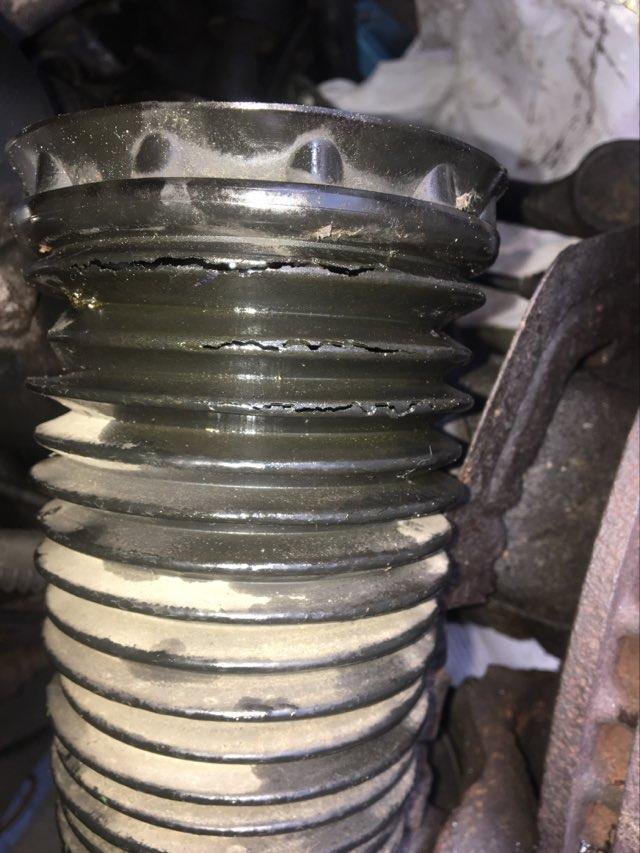

Cheers for the gaiter CitroJim
Skull's (CitroJim's) replacement gaiter fitted
Skull's old gaiter
Skull's old gaiter
Just got the original fault to replace now and buy some more LHM+ and we should be back on the road .....

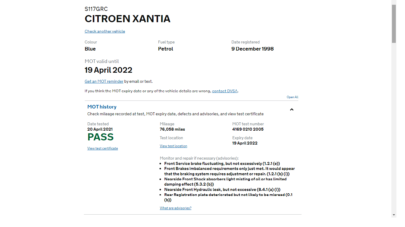

Skull's ACTIVA MOT
Skull's ACTIVA MOT
Well a PASS will have to do :-D
Cheers Jim for the parts and Thank You to the FCF 8-)

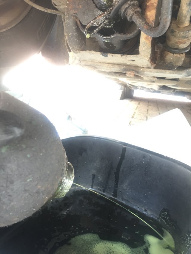

Rear spheres have gone solid during the lay-up and very jiggy ride which would be OK if I had a young lady sat in there :bouncy:
Spheres undone very easy compared to my old 2.1 TD (RIP) and squirted LHM from the sphere for quite a while .... I presume that's normal due to the smaller valves on the Activa spheres :?:
Skull's Activa rear spheres
I'm going to try to re-pressurise these with the DIY kit I bought off thorter if the membranes are OK there will still be some pressure left in them ....

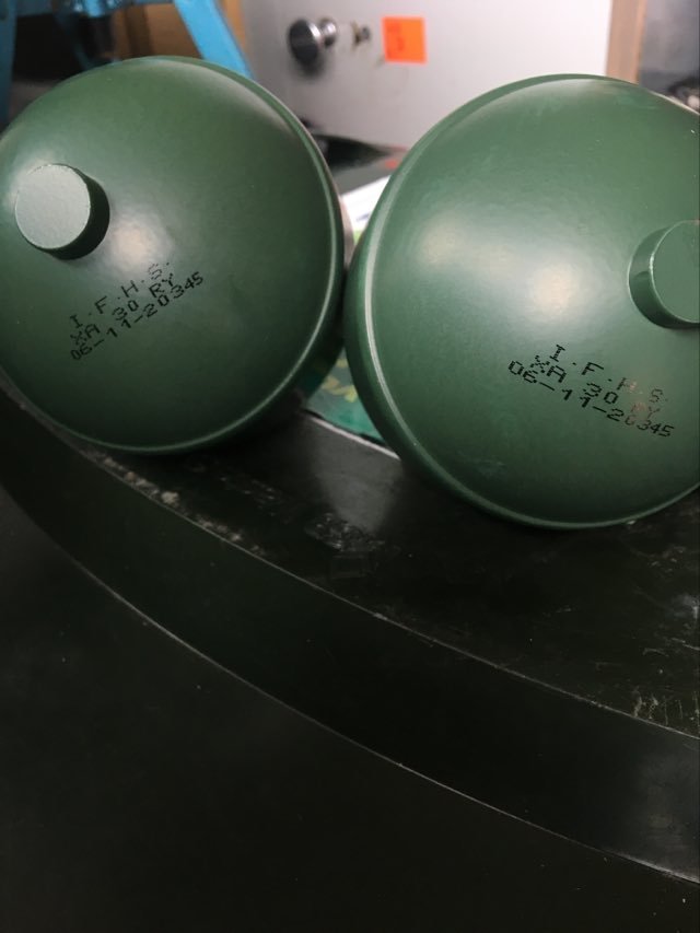

Well Cento16v it appears GSF don't really know their sphere's or their ordering system is flawed, the ones they sent for my registration didn't look correct on the valve aperture and when I emailed them they confirmed they were incorrect and told me the code I needed which when I checked was for front spheres [-X
Ended up getting IFHS sphere's from AEPdirect.com which were correct and arrived next day - ride restored £75.60 total + Ltr of LHM+

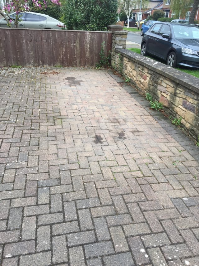

:bigcry:
teardrops on my driveway
Sold
It's gone to an ideal home though, a very nice young lad from Lancashire, whose Dad is an ex Citroen Mechanic ....keep your eyes peeled for it's makeover >>>
