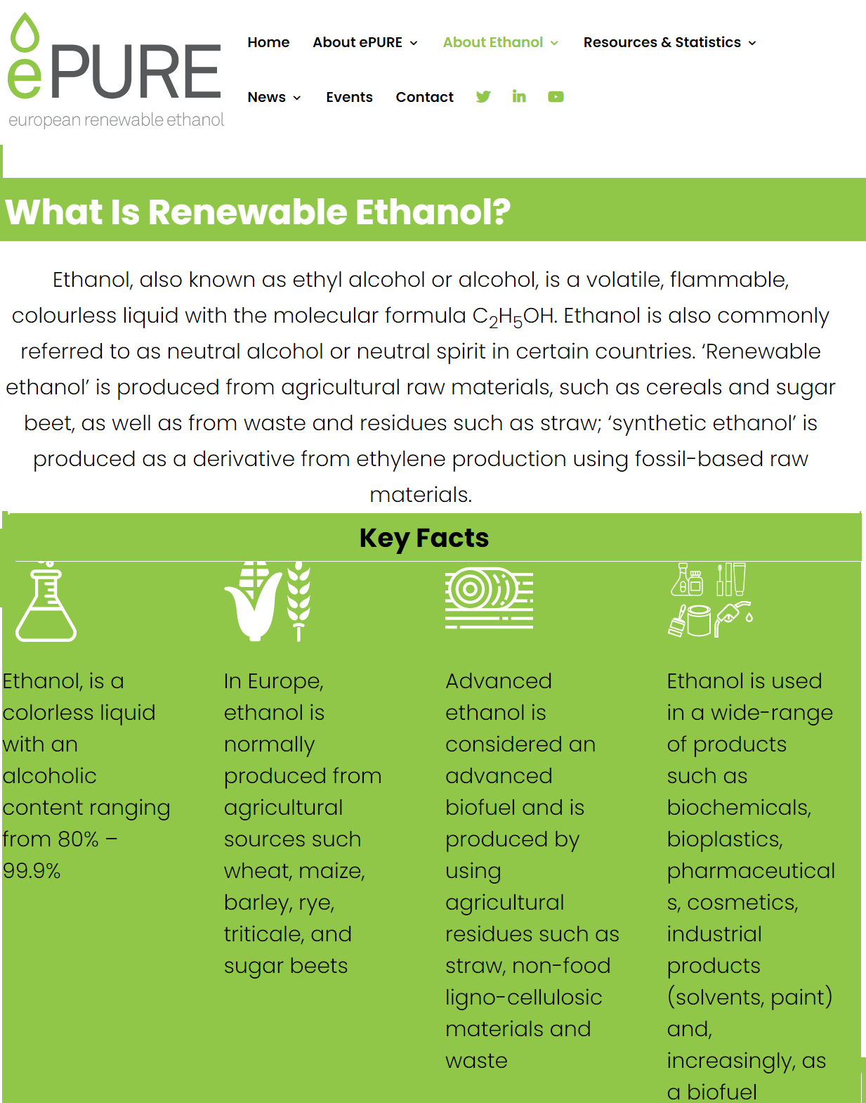

Re: e-fuel, synthetic fuel, bio-fuel still alive?
In Europe, ethanol is normally produced from agricultural sources such wheat, maize, barley, rye, triticale, and sugar beets
https://www.epure.org/about-ethanol/wha ... e-ethanol/

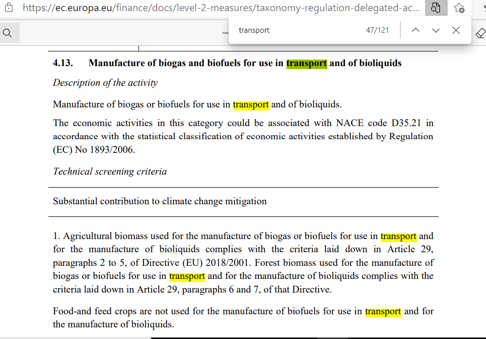

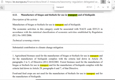

Took a bit of finding, but on page 94 of 196 of Annex 1 to the draft European Commission Delegated Act on climate-related objectives, this little phrase appears...
The European ethanol and biofuel lobby want the phrase eliminated. Recently there has been an increase in imports of Ethanol to the EU from Brazil the USA and Canada. Wonder how much policing goes on of the non-food or feed crop source of the E put into the E10?Food-and feed crops are not used for the manufacture of biofuels for use in transport and for the manufacture of bioliquids.
