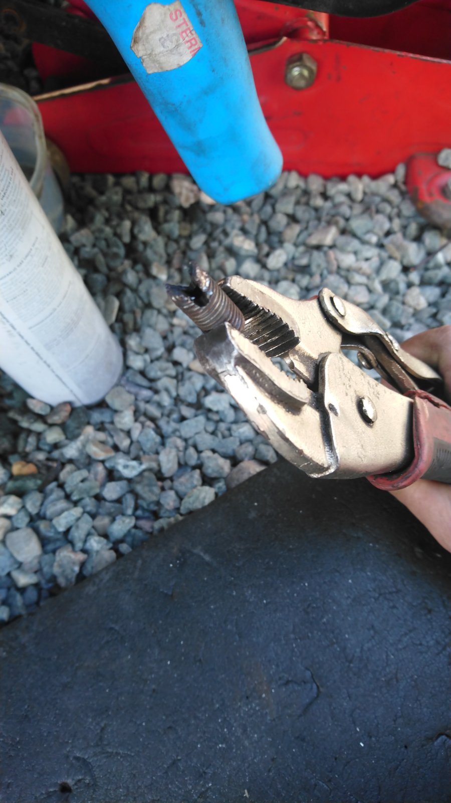

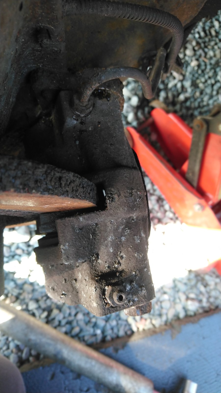

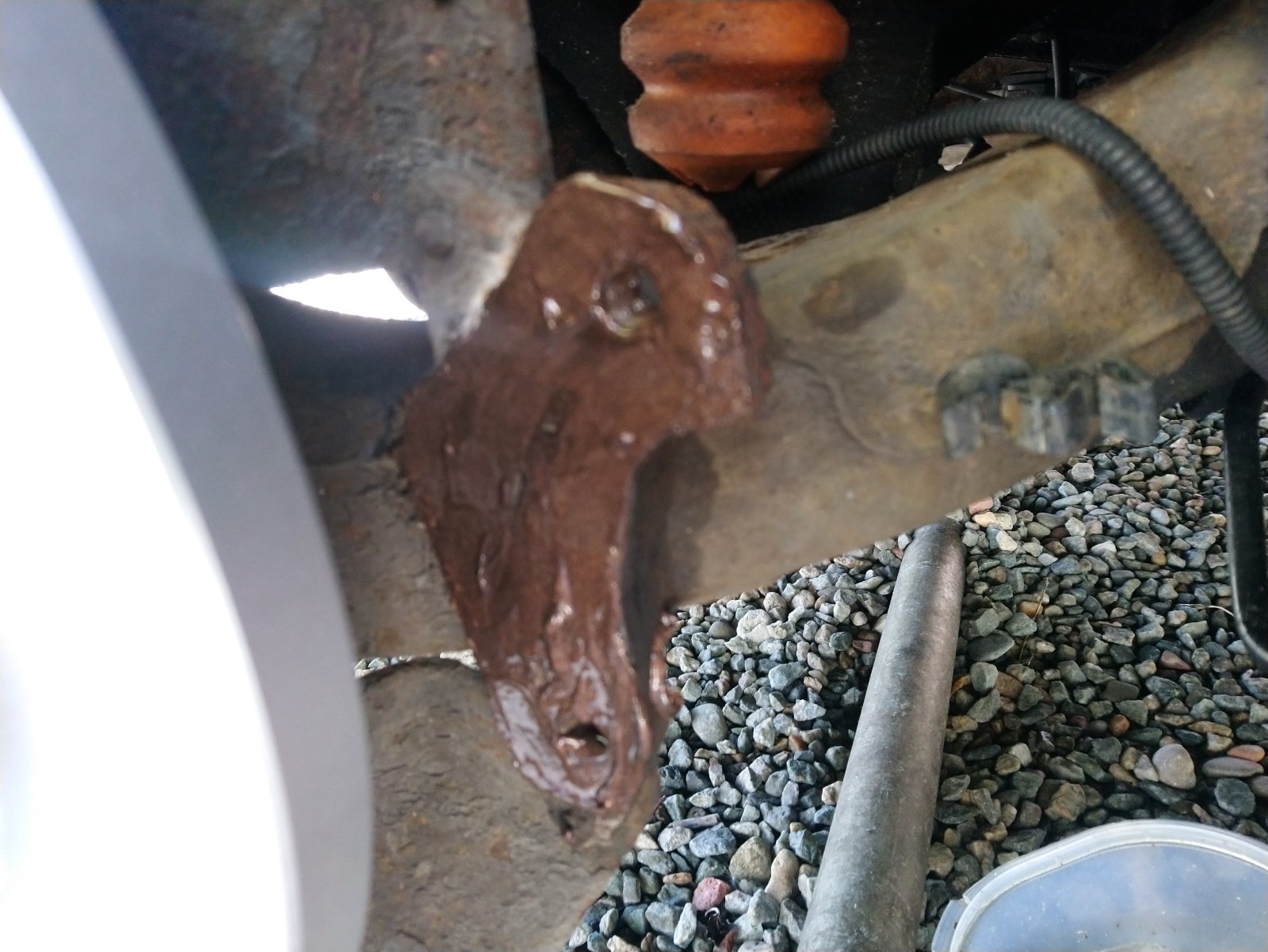

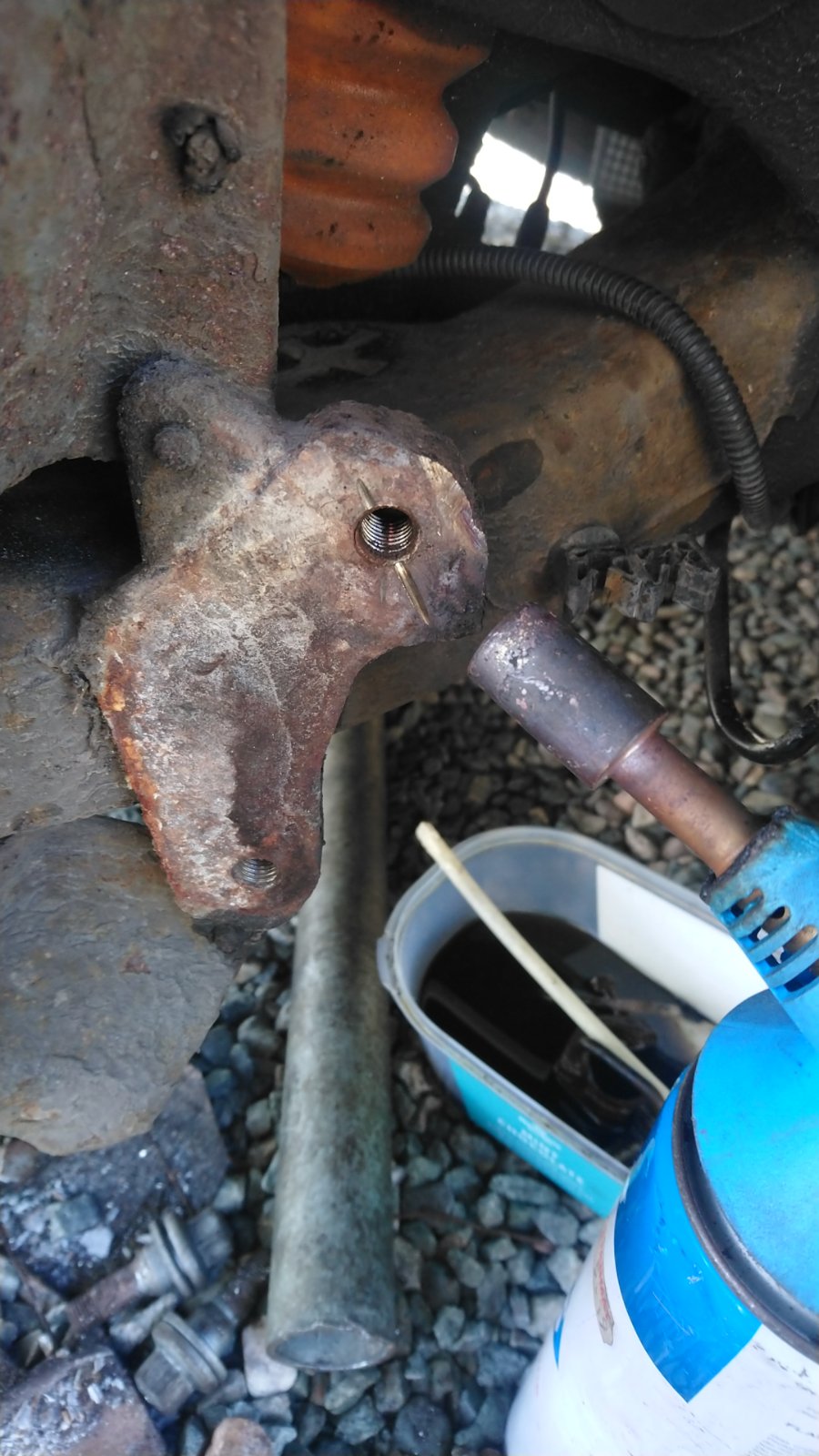

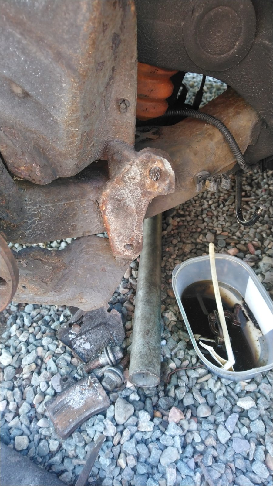

Further looking over shows rear calipers in a bad way..
Bottom bolt came away.. But not out the caliper however the top one snapped at the head so a had to resort to cutting the bolt at the arm mount point..
The brake pipe also snapped at the caliper and it broke on a bend further down too.. However a replacment pipe was found on ebay for 17 quid..
I then managed to get enough stud to make a slot for a screw driver on the caliper bolt. Bit of heat and out we came...
And there we are for another week..
Needing to recover after that lot.. And waiting for parts to arrive..

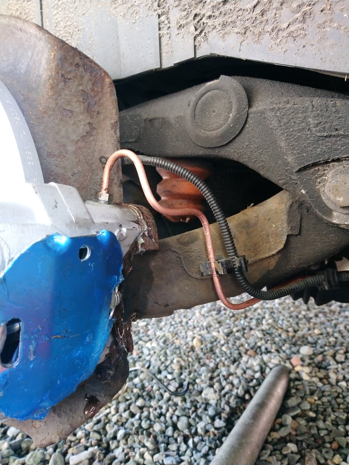

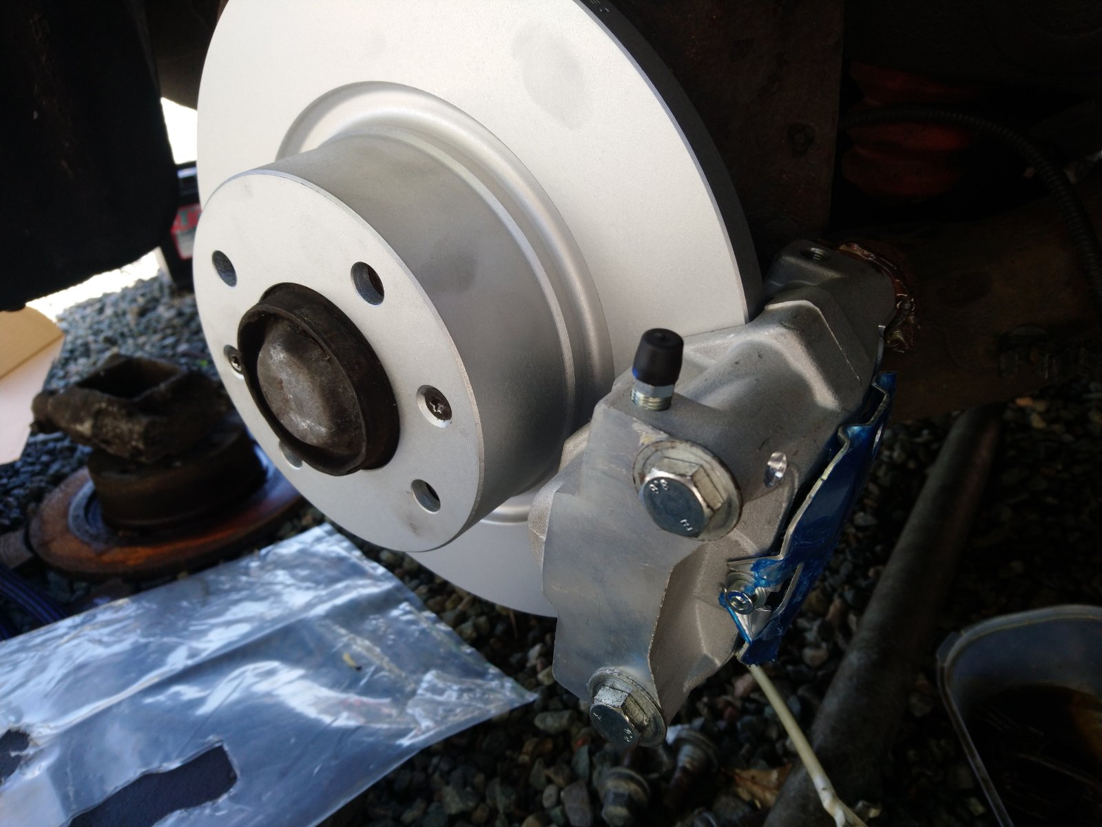

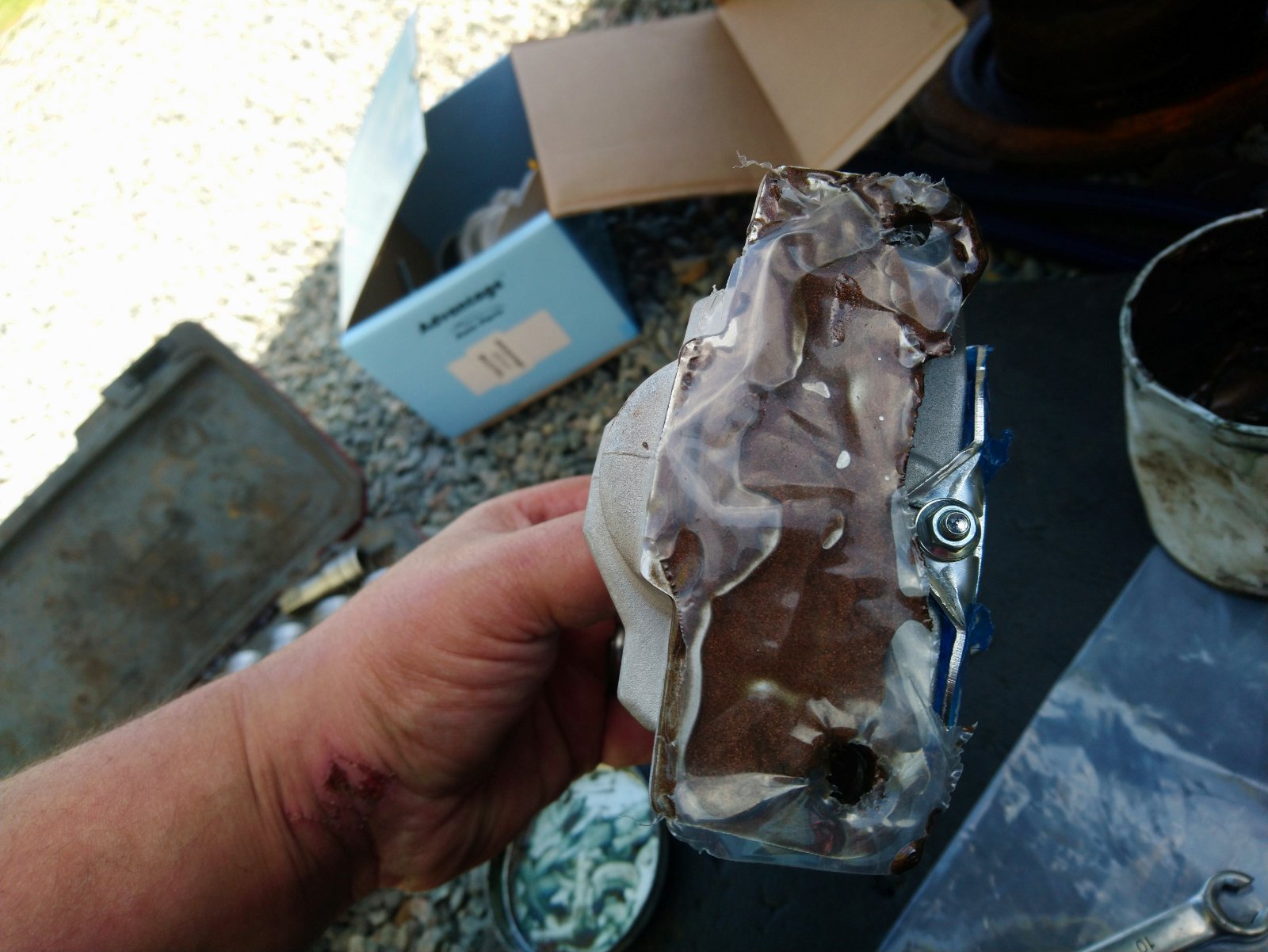

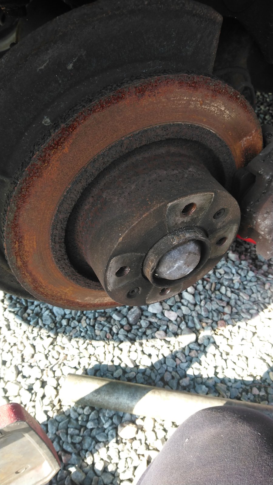

So a week later.. And reassembly commenced..
We have new calipers.. New discs.. New pads and new caliper bolts and new brake pipe
Cut out some plastic template sheets to go between and caliper and arm plus copper slip..
Disc.. Caliper and new bts on..
Brake pipe on..
And an interesting observation...
After fitting the new brake pipe and tightening it all up I opened the bleed nipple on the caliper while I put the pads in etc. However after a while the brake fluid was comming out the bleeder.. So.. I started the engine closed the bleeder pumped the pedal and then put a tube on the pedal between seat.. Opened the bleeder and out came some air.. Repeated and got the air out.. Fitted wheel and tightend the studs up with the brake on..
Completely done over now.. But hope to god the other side is Easyer..
Brake pipe on..

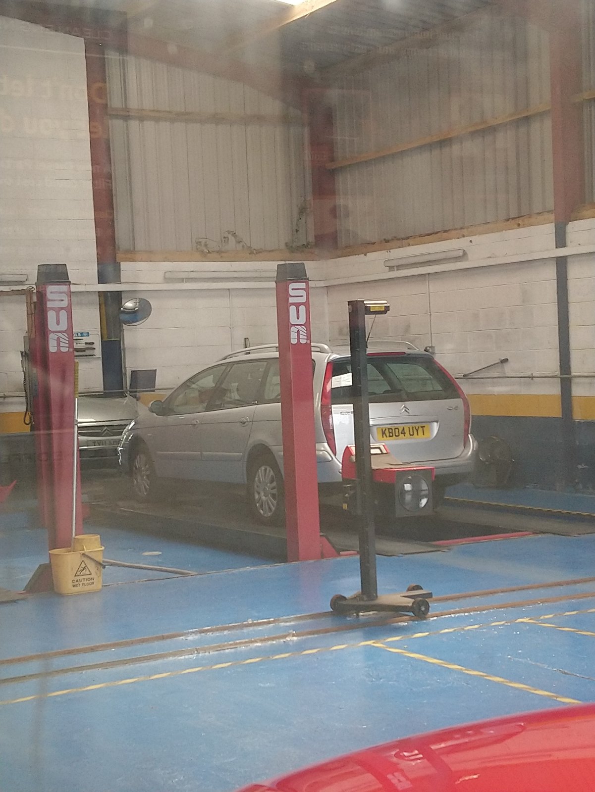

Swapped my insurance onto the C5 monday and booked an MOT for today 2 june. Took it in, and with the replacment MAF meter the power was not lost for one moment, however on over run both times the EML came on,but no loss of power..
Upon reading it gives codes P0400, and P0402, which im led to beleve on each one relates to too low air flow from egr, and the other is excess.. So out of trial tried another Electro vaccum Valve, and with engine idleing popped the vac pipe off the egr valve and felt a very strong vaccum, as i took the pipe off the egr valve it gave a nice positive pop ... anyway, connected it back up and went out again, covering 60 miles today it came on again.. So, all I can think is that despite a new EGR valvein place I cannot ruleout that the egr valve has either a gasket missing, egr pipe clamp missing or the valve is simply faulty..
Other then that a super ride and drive. Very pleased. and no advisories too..
In inspection..
So half the problem solved.
In inspection..
