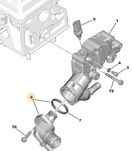

and a 207 5 DOOR SALOON 1.4 i 75 (TU3A) Manual gearbox 5
This has a thermostat at the front which is available separately:
Item (6) Part: 1336Z2, £72.54
Moderator edit:

The stat part no. that Marc quotes is indeed the item that I cannot get to function.
I'm going to try and fit a standard mechanical stat. tomorrow meant for an earlier engine. Part no. 1336Q2. If it works I think the trade off will be a constant MIL
