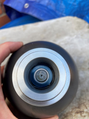

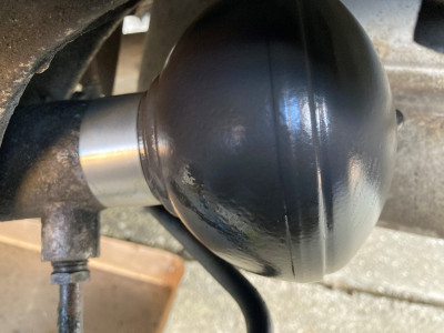

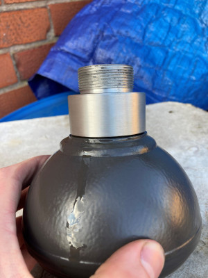

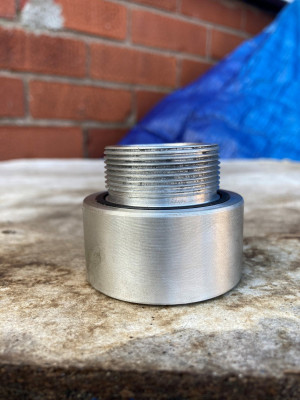

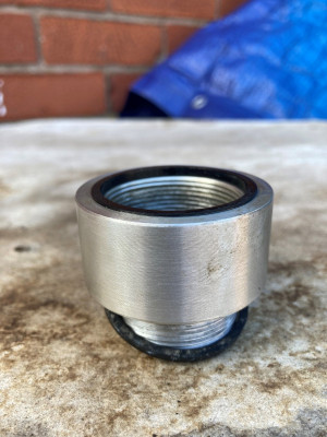

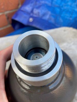

Hi folks

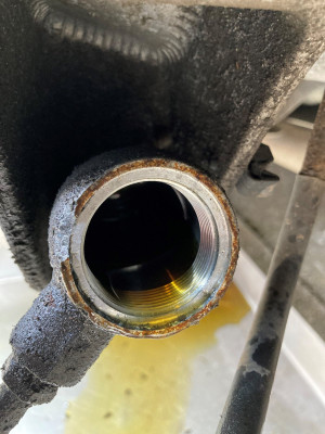

I've recently had the dreaded corrosion issue around my C5's rear cylinders. In their defence, they were original to the car, fitted 14 years and 150k ago! So it was me that kind of dredged this thread back via citroenxm...
Anyway, I'd pondered about repairing the cylinder using an adapter of sorts, with grooves at both ends to provide a new seal against the cylinder, as well as a new seal for the sphere into the adapter. I'd described this to my brother who's an engineer, and has his own lathe. More often than not I suggest engineering things to him and it's nearly impossible because I don't understand how to use a lathe, but this time I'd suggested something that was doable.
So sure enough with my shoddy description he managed to make this up on my lathe (see photos attached), and it's a great piece of engineering. Most importantly it works perfectly. The one and only downside is that it requires two sphere seals, which is hardly the end of the world.
Over a week later and we are still leak free!

Excellent solution! Well done. Does it affect the suspension at all? I guess there must be 50 to 100 ml extra fluid in there to compress. I wondered if it would make the ride better by being slightly softer, like comfort spheres?

The extra fluid will not affect the suspension, as the fluid is not compressible. The gas remains the same.
I vaguely remember seeing an advertisement for adaptors looking rather like this, intended for fitting the larger diameter saucer spheres in place of classic spheres, where clearance was an issue.

Thanks for the kudos! As Chris says, the fluid simply transfers the energy from the cylinder into the sphere's gas, so there is no difference in terms of how the suspension rides. Interesting link there Chris, it's essentially what we have made isn't it without realising it had already been made!
