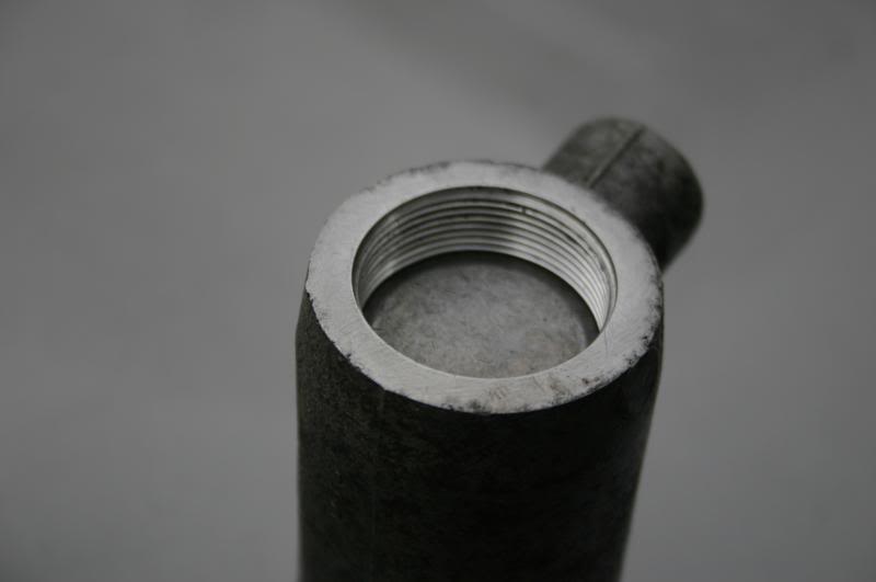

No longer do you have to go looking round breakers for a suspension cylinder when corrosion around the rim

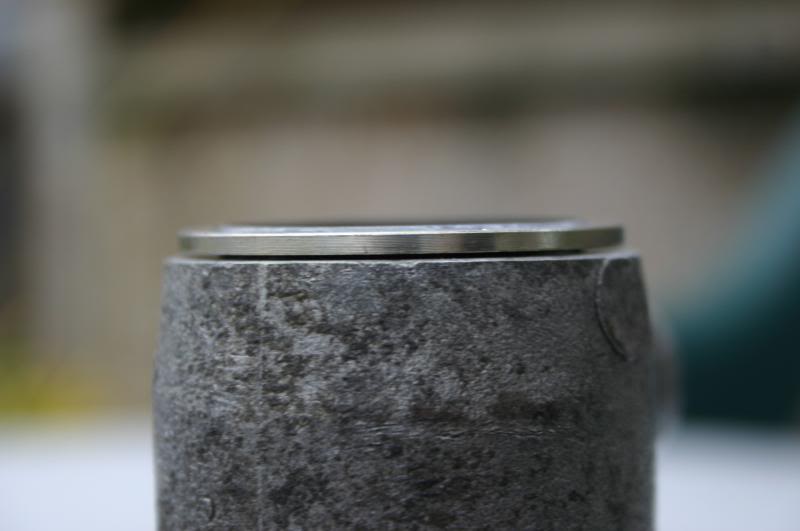

Image means it has let go and started leaking. Today I ground down the rim and then emry papered it so there was a smooth finish.

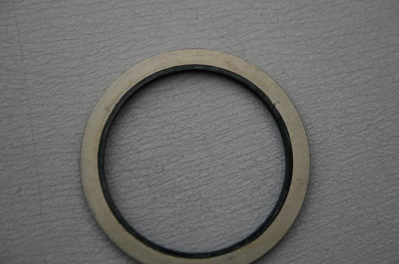

Image . careful to keep it square to the sides of the cylinder. Removed the old cylinder..in !0 minutes !!! Even bigger smile :-D and replaced it with the new cylinder and a Dowty seal Image Image, I added a bit of Bule Hylomar seal as an added extra, Put it all together and .... No leaks!!!
I now have 11 Dowty seals for sale to members at cost £12.00 each. ( I had to order a minimum of 14)

Thinking about it, if you had a small grinder, you could probably do the grinding in situ, providing you could ensure thet the bits didn't get into the cylinder and piston.. that would save the agony of getting the pins out.

c.morewood wrote: Thinking about it, if you had a small grinder, you could probably do the grinding in situ, providing you could ensure thet the bits didn't get into the cylinder and piston.. that would save the agony of getting the pins out.
It would but I'd be very worried about swarf in the bore Chris and getting it sufficiently accurately flat to seal effectively might well be a struggle.
How did you grind it down initially?

VERY gently with a grinder.. there was almost an oops moment as I realized just how much disappeared in one pass.. but I managed to sand it out with Emery paper.
I'm pretty sure that if you used something like brake cleaner spray, that you could clean all the swarf out with the pressure.
The reason they're so expensive is that they're not a common size and not available individually.. I just thought that if they did work.. I still wasn't 100% convinced when I saw them..They'd save the forum members so much hassle especially those with Xantia between Rpo's 8209 to 8518.
