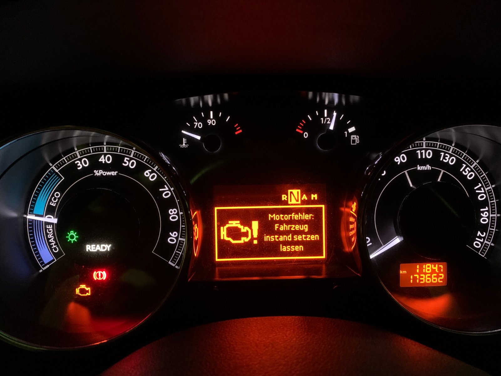

There is an annoying unsolved issue with my Peugeot 3008 Hybird (2012) for almost 2 year.
The symptom comes as follows: "Sometimes" an error message pops out when the car is just ignited or when the car is driven under a slow speed. Stopping the car right away and re-igniting won't remove this error. The translation of the error msg is something like "motor failure: stop the car urgently" as attached. (I bought this car from a friend in Germany).
My observation: When the error shows up, the driving power from the engine doesn't work anymore, and therefore the only source to drive the car became only the hybrid battery, and generally the car can't accelerate above 50 km/h. After driving for around 1-2 km flat road , the battery will run out of capacity. At this point if I switched off the car and re-ignite it, the error message will disappear and suddenly everything became just fine. The car can work just perfectly for the remaining of the day.

The translation is "engine fault have the vehicle repaired".
We can't really help without any fault codes - and if you have already taken it to Peugeot, I suggest you take it back to them. The speed limitation will be because the engine ECU has limited the power because of a certain fault / condition. Without knowing the actual fault then you will be changing parts needlessly as you have found out. If you have paid a dealer to diagnose the issue, then they should be able to tell you what is wrong with it.

When the "Engine Repair" warning light comes on is it only Amber (yellow) or go Red? Have any other amber warning lights come on either on their own or with the Engine warning? Your picture shows Amber but has it ever gone Red.
