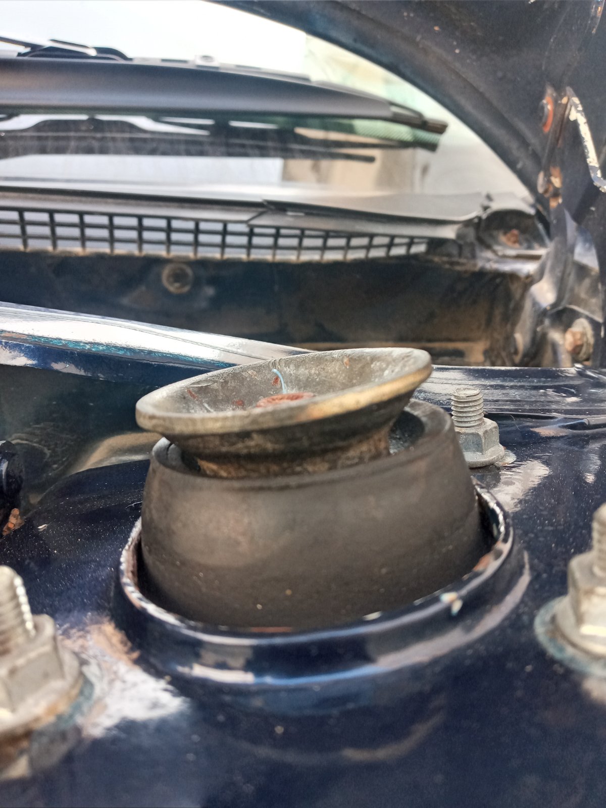

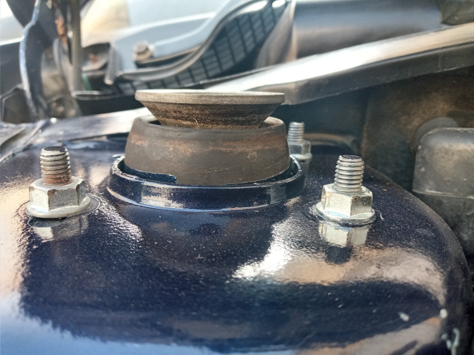

Unread post by Jonathancilia »
This is the bad strut side top mount, it squeaks alot and the top mount seems collapsed as it is higher than the other one

Jonathancilia wrote: 02 May 2021, 08:34 ImageImage
That suggests the strut top bearings may be worn, as I advised earlier...

Update: i replaced rhe brake shims with brand new ones, clunking is not bad now definitely less. But there is still a bit of knocking over bumps, i have ordered a set of bilstein B4 shocks and a set of brand new top mounts and bearing so i replace the whole lot.
Posts: 55027
x 8360
Re: Suspension noise
Jonathancilia wrote: 04 May 2021, 06:39 Update: i replaced rhe brake shims with brand new ones, clunking is not bad now definitely less. But there is still a bit of knocking over bumps, i have ordered a set of bilstein B4 shocks and a set of brand new top mounts and bearing so i replace the whole lot.
Excellent! Good plan :)
