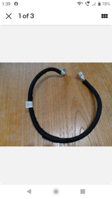

And is this the fibre obtic connecting lead? I don't have it on mine..

Ok, so your vehicle and my old C5 II have exactly the same RT3 units and yes, they have fibre optic connections. That cable in the photo is not the same and looks like a standard LVDS cable connection probably used in the later RT4 units.
So that means that your current colour display screen won't work with the newer unit you are attempting to fit.
