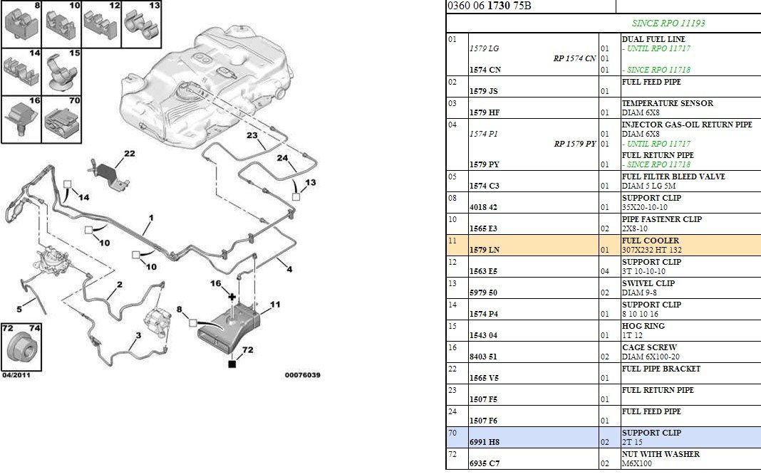

Harlequin wrote: 02 May 2021, 19:16 Saw a C8 today, with what looks like an airscoop underneath the chassis, nearside close to the passenger door / wheel.
What is it for?
Its a fuel cooler air scoop.
Its also used for ripping the fuel cooler off if driving through heavy flood water & used as a snow plough to also rip the fuel cooler off :-D
I have replaced more fuel coolers & pipes than i can count on the C8/Dispatch due to this air scoop every time there is a bit of snow.

wheeler wrote: 02 May 2021, 20:19 I have replaced more fuel coolers & pipes than i can count on the C8/Dispatch due to this air scoop every time there is a bit of snow.
That’s odd, I’ve covered over 165,000 miles in my C8 and never once had a problem with the scoop, although it does seem to sit a little higher than the pic in harlequin’s post.
I live in the country and I’m not excessively cautious with my car - the scoop does have a few battle scars but never a major problem.
