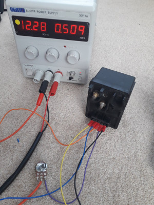

After disconnecting the GP relay I cobbled together a makeshift jig and tested it indoors using a bench PSU.
Pins: 1 & 3 supply, pin 4: alternator (positive trigger for post timer), pin 2: PTC thermistor/temp sensor (I substituted this for a potentiometer), pin 1: glow bulb. It worked as intended?
I replaced the failed Champion plugs with two original BERU plugs, reinstalled the the GP relay back in the car with a multimeter connected to the switched output instead of the the GP's and started it.
It was a pig to start without any power to the GPs but multimeter showed the relay switched the output on for 3 minutes then off from cold. I reconnected the GP's, started again measuring the output and it switched off after 3 minutes. I ran the engine until the fans kicked in, stopped it and restarted the engine. This time 10 seconds elapsed and relay switched off. It now seems to be operating correctly?
Did I disturb an oxidised connector, or have two new plugs failed within a day?
I will attempt a cold start in the morning, albeit with air being sucked in through the leak in the fuel housing. and see how it fairs. If all is good I'll invest in 4 new BERU GP's

Looks as if it might be operating pretty much correctly.
As you say, could be a bad connection, preventing proper shut-down.
While it's off, open it up (cover usually pops off) and clean up the internal relay contacts (often a HD pair and a smaller pair), as well as the base contacts.
These relays usually enjoy a very long life, 10-20 years+.
Similarly, BERUs normally good for 10+ years minimum.
Most common faults are corrosion of the relay's main HD base terminals (up-front weathering).
If in doubt about its performance, rig up a test lamp/LED onnthe output, so you can see what it's doing during and after start-up, and keep an eye on it.

Thanks Chris,
I came to the same conclusion earlier and asked them to order the correct 039's and not the 034's which as you pointed out are Fiat / Lancia compatible.
