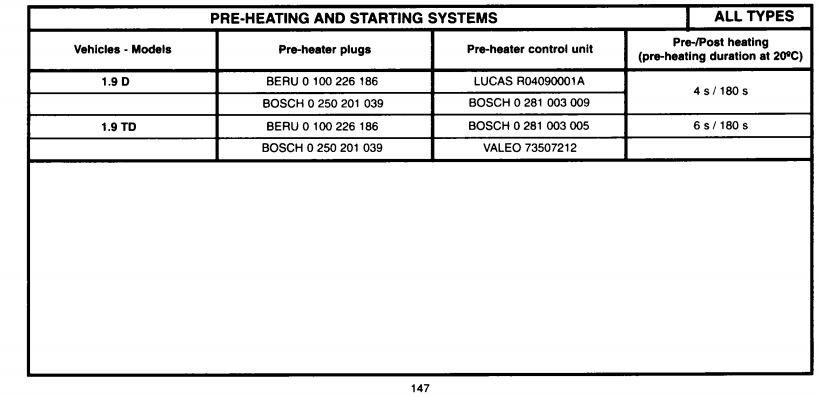

BERU's (and presumably others too) should pull 9-10A each at 11v.
Sounds as if the GP relay has failed. Try running it up on the car, but with a test-lamp (eg headlamp bulb) connected instead of the GPs, to check 'on' times.
Found Citroen data (1998) confirming GP-type and GP relays fitted to Xsara:

Chris, thankyou for your assistance, it means a lot.
you are indeed right, 9-10A draw for working plugs.
Is it worth replacing all four plugs with BERU once the relay has been replaced or replace just the two open circuit Champion CH68's. My guess is the two remaining plug may have been unduly stressed and life span reduced?

Well this morning I rigged up a lamp and stated the engine. After a very brief splutter and miss, presumably due to there being air in the fuel line it started with very little smoke, and idled sweetly. The lamp remained lit for exactly 3 minutes and extinguished accompanied with a rise in engine note as GP current draw ceased.
I contacted the motor factor I purchased from explaining that two GP's had failed, they didnt appear surprised stating some do occasionally fail and immediately offered a replacement for the failures. I mentioned my reticence regarding the longevity of the Champion GP's and asked if they could exchange all four for a different brand, they agreed.
They didn't have a supply chain for BERU but can supply BOSCH which I have opted for. They originally quoted part no: 0250202034 from a NGK cross reference guide. I questioned this as it differed from the Part no suppled in this post ( 0250201039 ). They are now ordering these and should be here in a few days.
Now I need to concentrate on rectifying the fuel leak.

The Bosch GP 0 250 201 039 is the one listed for the car.
Mister Auto quote it as well, and have it in stock.
This is their list of equivalents for the car:
https://www.mister-auto.co.uk/glow-plug ... 0-201-039/
....034 is shown for Fiat and Lancia.
I'd insist on the right one.
Just make sure all dimensions (particularly the length) are the same as the original BERU's.

Thanks Chris,
I came to the same conclusion earlier and asked them to order the correct 039's and not the 034's which as you pointed out are Fiat / Lancia compatible.
