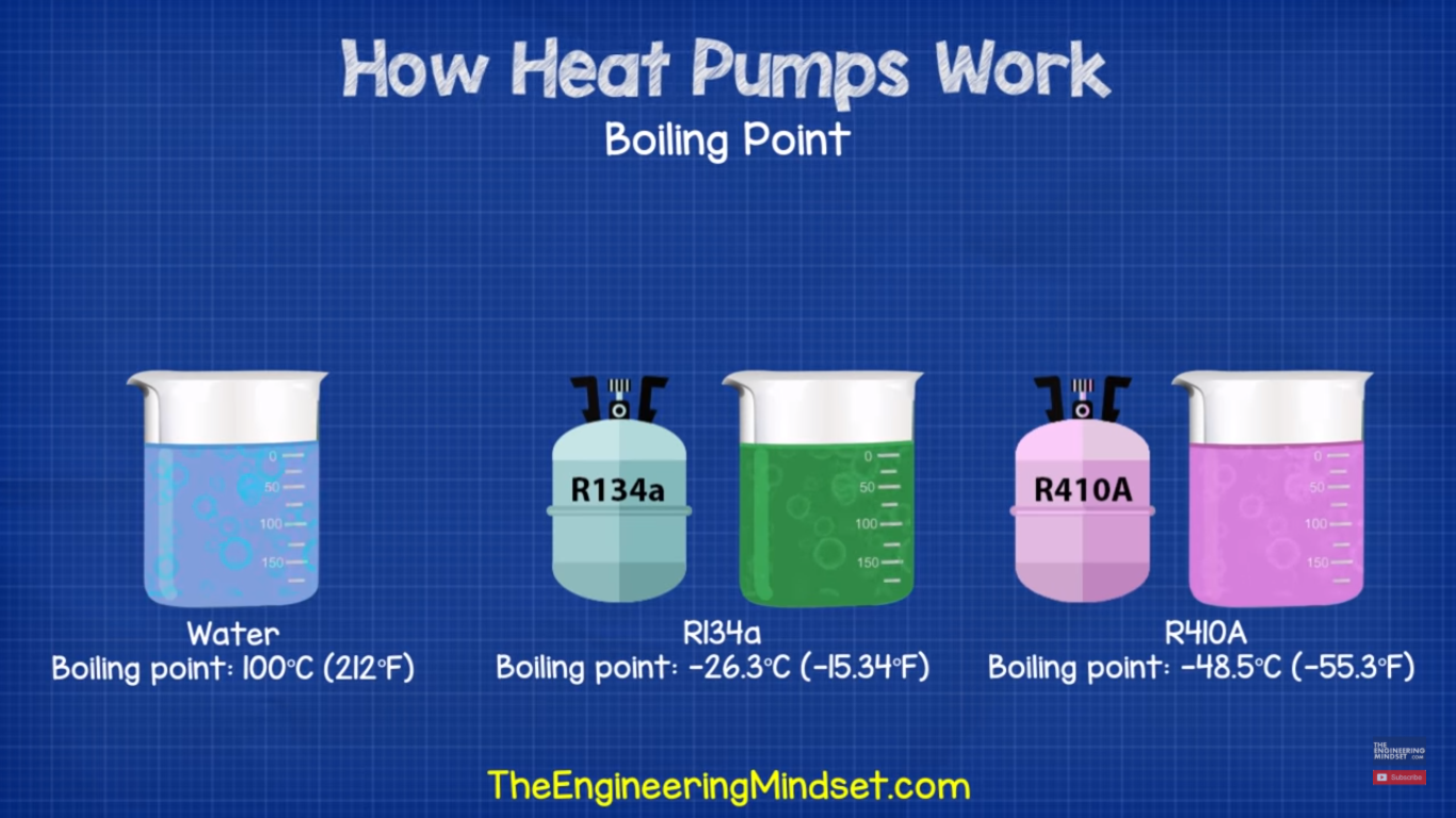

So what's the stuff that courses through the pipework, valves compressors and heat exchangers.
This stuff with its useful physical properties, part of this informative vid here. link
What's the bets the pink stuff is more expensive than the green stuff
These Hydroflourocarbons (HFC) are in worldwide use in refrigeration, air-conditioning and if the scaling up away from gas happens, in heat-pumps on a massively large scale than at present.
In themselves HFC's replaced the Chlorofluorocarbons (CFC's) well-known and banned for their environmental impact on the ozone layer.
