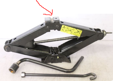

Re: C5 X7 bent(ing) jacking points
That's the ticket ^
You can see the jack has the groove:
