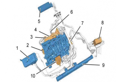

Ok, so you have the 175 DW12BTED4 engine. Can you identify the pipe from the following 2 pictures which are essentially the same?
(1) Expansion chamber.
(2) Coolant pump .
(3) Water inlet housing.
(4) Exhaust gas/water exchanger.
(5) (/) heater matrix.
(6) (/) bleed screw(s) .
(7) coolant outlet housing.
(8) additional heating (according to equipment).
(9) engine cooling radiator.
(10) (/) coolant/oil heat exchanger.
citroen since 1973
Posts: 55
Joined: 01 Jul 2019, 23:35
x 12
Re: C5/X7 2.2HDi leaking metal water pipe from engine block
Unread post by citroen since 1973 »
I'm sorry Marc, I should have taken a photo of the part at the garage yesterday and the car is now 35m from me! From what I can remember, the pipe wasn't a large one (like a rubber water hose), it was metal, I thought that it came from out of the front of the engine block and from the diagrams above, it may have been 7 - the coolant outlet housing. I'm sorry that I can't be more specific, but please don't spend any more time on it. I do appreciate your help, but I'm not being much use and I thiink that we'll just have to wait until he can get it into an engine specialist. I'll report their findings back here. Thanks, once again, Paul.

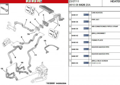

Can you identify it from either of these Parts drawings?
? click to enlarge
citroen since 1973
Posts: 55
x 12
Sorry Chris, thanks for your help, but I can't identify it. I'll report back at the end of the week. Thanks, Paul.

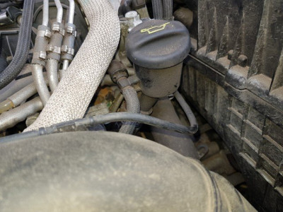

So, update and sorry this is later than I intended. We took the car to our local engine specialist last Friday. The car had been with me overnight, it wasn't a long journey and so wasn't up to temp when we arrived there. Sods law, it wasn't leaking, but there was sufficient evidence from a rusty deposit to show where it was. Turns out that it's a short, metal pipe coming from the cyclinder head, rather than the block, with a 90 degree angle welded/brazed to it. A flexible (rubber?) hose then attaches to this piece. There is/was a leak from the brazed joint (according to the first garage we visited), but it could easily be the hose, which is the more likely culprit. The engine specialist hadn't got time to strip the car down and with a Bank Holiday coming up, plus the certainly, they said, that the local Citroen suppier would not have the part, they advised popping some Radweld in and seeing if this, at least, gave a temporary fix. We did this, the cars been back and forth between Birmingham and Telford over the past few days and all looks well. Fingers crossed and thanks, once again, for all of your help. Also, sorry that I've bothered you about what looks like something pretty trivial. Thanks, Paul.

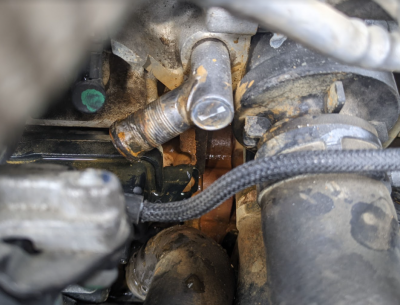

From the description, the same think has happened to our 2.2 HDi 4007.
The leak is from a metal pipe that is fixed into the head.

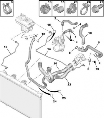

The rubber hose is #2 (in the black and white line drawing) connects it to the oil cooler.
The access in the car is not that easy.
It appears that there is either a fault with the welding of the branch, or some corrosion. How is this removed from the head for repair or replacement?

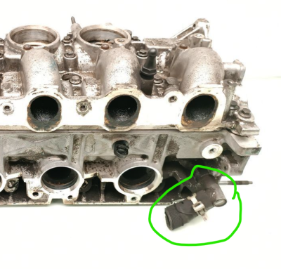

Hi! I had the luck to find the part on a parts distributors catalogue(ironically, they’re also a domestic distributor, the second option was ordering it from the Emirates, which would have taken a while), and managed to grab the last one they had in stock; it seems to also fit opel and GM cars.
I still haven’t had the time to change it, but most likely I’ll be back by next week with updates regarding this procedure. In order to access it, you need to remove the air filter housing, the thermostat(doesn’t seem necessary but would make the job a whole lot easier, considering that the thermostat can be removed in just 5 minutes), and unscrewing the two bolts holding the oil fillup and bending it to the side. The intake manifold doesn’t seem to get in the way too much.
I’ve seen on a post by a guy from Kazahstan, and even though the language barrier was in the way of completely understanding what he did to replace it, it seemed like it is press fitted in place. From the photos, after the removal(which seems to take a while; his was pulled out in bits), he proceeded to mount it with some black silicone.
