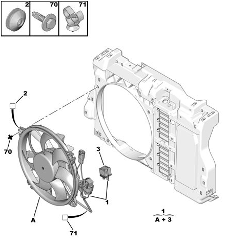

Ok, so none of those parts were correct.
The correct official part number is 1253N5 for the Fan and the Relay - items (1) and (3). Price form Citroen today is £597.43 inc. VAT. So I would be sure to check it is not just the relay that you need....
Any other part numbers you need, let us know.

Re: Febi to Citroen part numbers.
Yep £288 more like it.
Also, my local non Citroen garage say they can fit a fan for £200.
Will have to check if they are pricing with the £60 Febi, that won't fit!
My relays are different from image.
Round with a seperate cap to twist off.
This fan has the integrated relay which you need and specifically this fan is the 150W with integral electronic control.
So be wary. The part I have provided is the official part for your exact car - be careful of 'compatible units' that may be different specifications / fitment / control.
