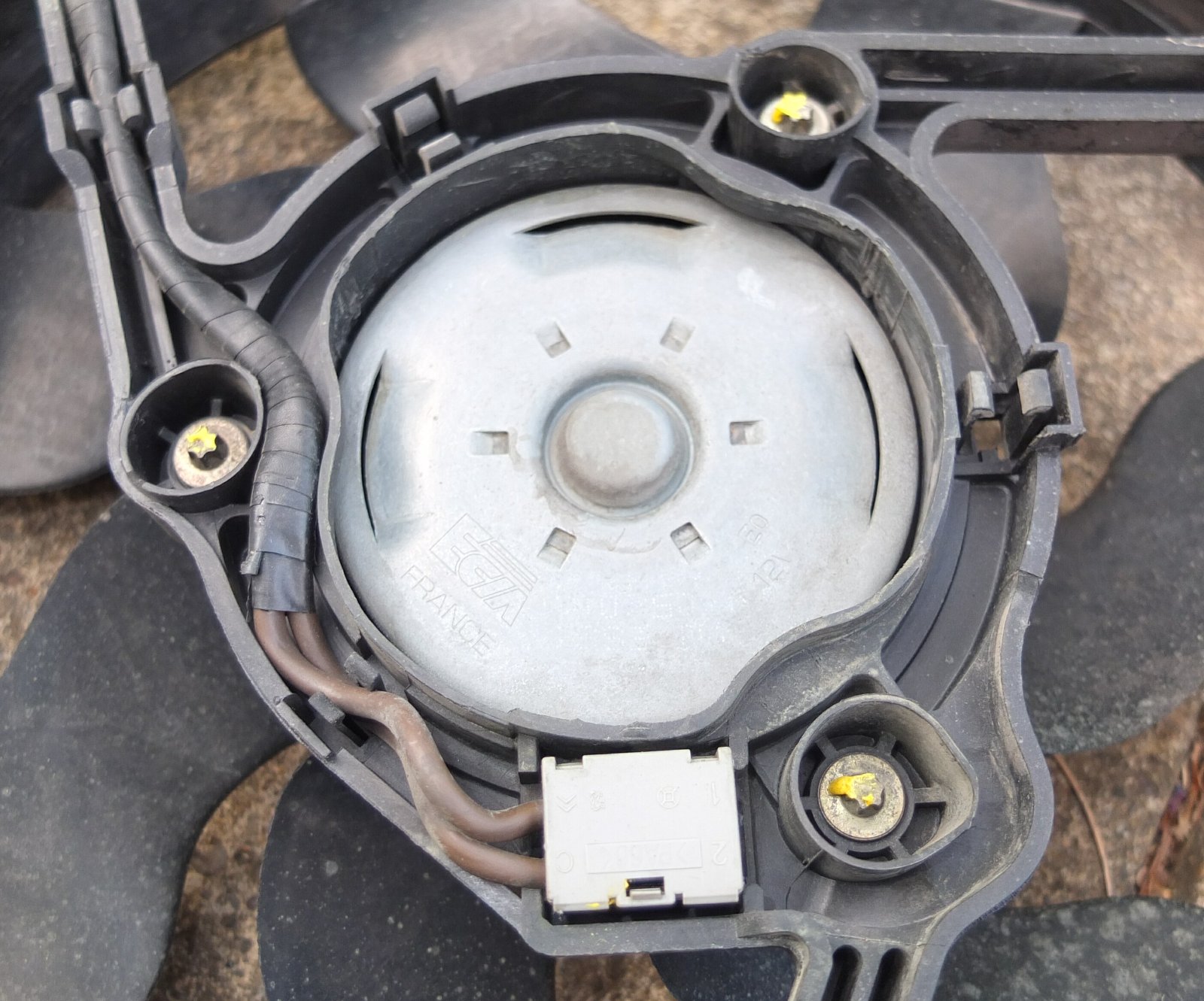

Here's my special tool for getting at the 10mm cooling fan motor fixing nuts on a Xantia without needing to remove the rads and A/C condenser...
Having a 13mm hex on the end means a ratchet spanner can be used and that makes the job even easier...

The later ones had this kind of inverted Torx drive fasteners, which stumped me completely when I was trying to avoid stripping down the front of the car.

In reply to Myglaren's sump plug, I was taught to tighten bolts up until they break and then turn them back half a turn - followed by a clip round the ear. The inverted torx heads respond to a pair of mini vice grips with a vee notch in the middle of both jaws.

I prefer to use my torx sockets!! The thought of any sort of grips used on bolt heads fills me with terror!!

It did for me too at the time. But I needed the screws out, I didn't have the luxury of my full workshop toolkit and it was a toss up between the mini vice grips and other forms of brute force and ignorance. I cut screw driver slots in the screws to aid putting them back in. PS you really should also refit proper replacement screws but the originals went back in and were still there 3 years later when the rally car was sold.
