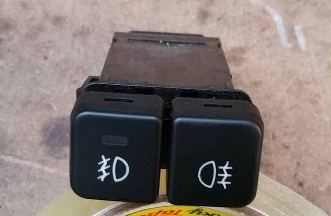

I wanted to fit front fog lamps to my hairdryer as I always think it looks somewhat naff having the black plastic blanking covers where the fog lamps should be on them. No problem - I got a set of second hand Jagwarrrr F-Type front fog lamps as they're the same as the MX5 ones, but a hell of a lot cheaper second hand.

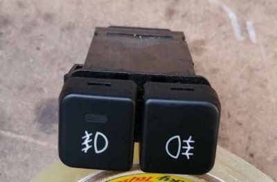

I procured a used MX5 double fog lamp switch (front/rear) which goes into the same hole as the old single position rocker one.
MX5 fog switch
MX5 fog switch
The only issue was that one of the switches is designed to latch, and one not. No problem, the non-latching bit can be overcome with more wiring and relays....... But I'm a cheapskate :lol:

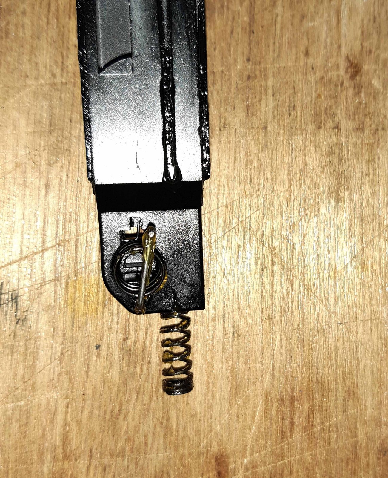

So...... out with the screwdriver.
Fog switch internals

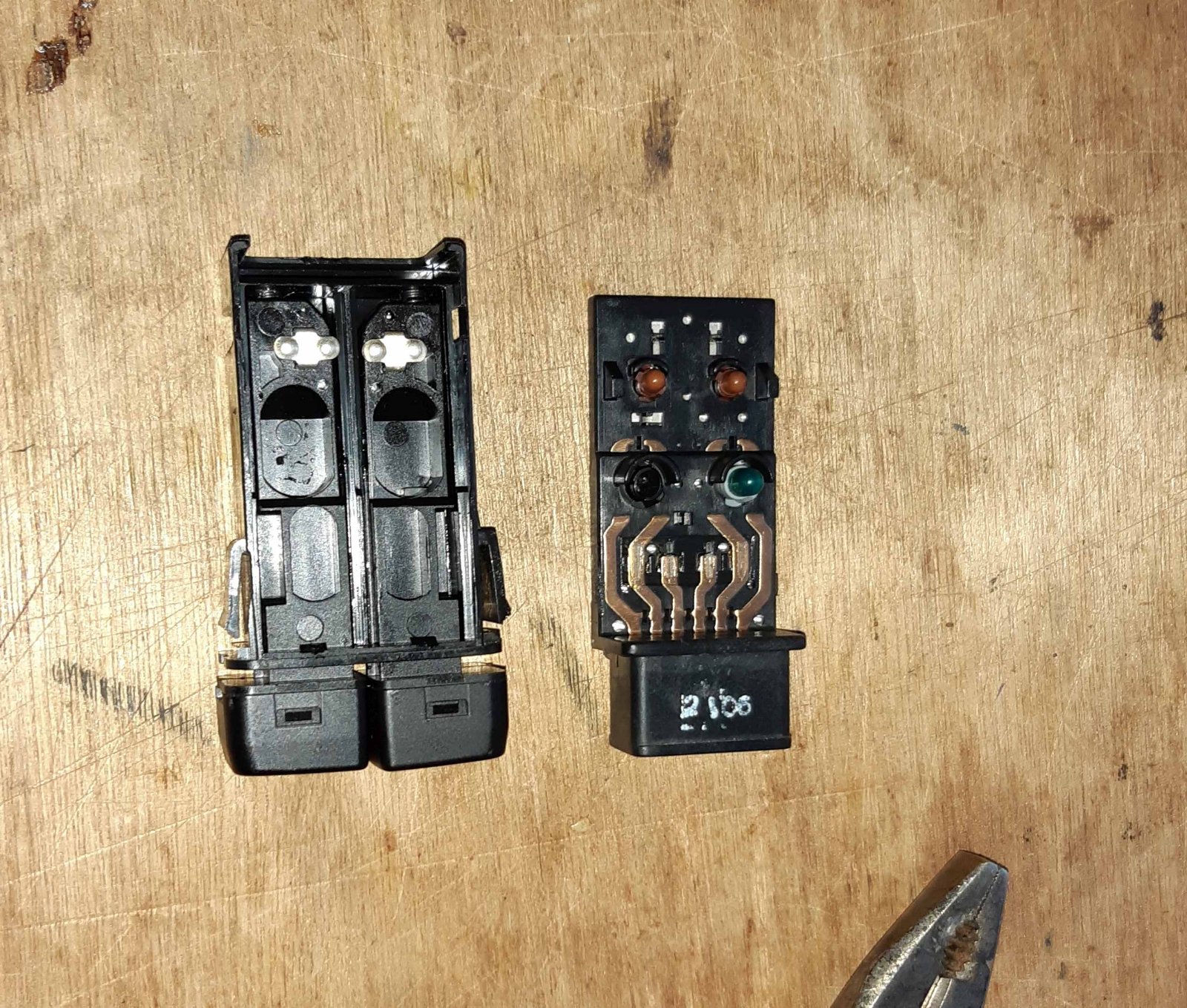

Take both switches out and see what makes them tick.
Here's the latching one. The two components more or less in the middle of the switch are what make it latch - a small spring with a bent bit of wire resting on it, and another spring sticking out from the end. I'm sure you're ahead of me here :-D
Switch latching bit
Switch latching bit
The non-latching switch already had the spring recess and wire pivot hole molded in, so it was just a case of..........
One small butchered spring, and one paperclip that gave its life so something else could work later, and I'd replicated the latching mechanism in the non-latching switch. Result ! :)

bobins wrote: 27 Dec 2020, 16:44 So.... what to do ? :-k
I note there is no tell tale on the rear light part of that switch bobins, so I assume you are fitting an aux reminder somewhere? After all having made it latching it wont go off with the lights and so come on whenever you put on the headlights unless you have remembered to switch it off. Don't want to join the mindless moron group that drive around with fog lights blazing on bright rainy days now do we? :-D

x 3565
Re: Toolbag Tales-Homemade and improvised tools
Already taken care of - I've simply transferred the wiring from the old rear switch to the new switch which incorporates wiring to the dash rear fog warning lamp. One of the switches will illuminate its own internal lamp, and the other will light the dash light. :)

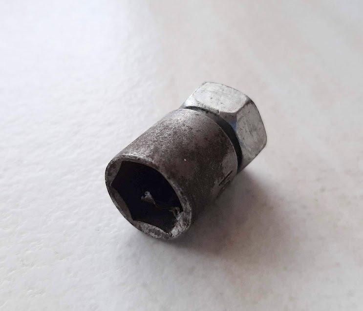

Here's my special tool for getting at the 10mm cooling fan motor fixing nuts on a Xantia without needing to remove the rads and A/C condenser...
Having a 13mm hex on the end means a ratchet spanner can be used and that makes the job even easier...

CitroJim wrote: 16 Apr 2021, 17:45 Here's my special tool for getting at the 10mm cooling fan motor fixing nuts on a Xantia without needing to remove the rads and A/C condenser...
Newcomers to the FCF, I have just had a flick through this thread looking to see if I had posted up my version of Jims tool. Its an excellent thread if I say so myself, If anyone has anything to add please do.
So my version originally was a double sided sump plug removal tool. Removed the smaller 8mm side square with a hacksaw and that left a 19mm body, and the remaining end was just a square end which fits all sockets.
It came to life to remove the centre inlet manifold bolt on a Xantia, 13mm if I recall right and just a plain hex head bolt, where the access was awkward. I have a more slender version fashioned out of a bolt with a grinder.
