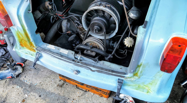

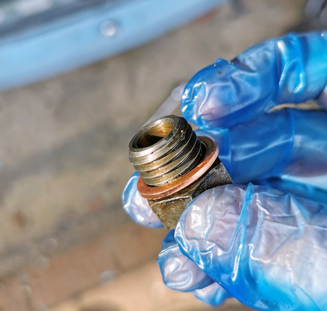

As mentioned above, TPA has been marking her territory since the last oil change.
This is because the idiot doing the service for reasons utterly unknown decided to refit the rather dog eared copper washer rather than replacing it. Which would have required him to walk all of four feet to pull one out the box.
This has now been rectified.
On the plus side, the sump only holds 1.75 litres of oil so I haven't wasted much by changing it twice in 200 miles.
On the downside, the sump only holds 1.75 litres of oil, so you *really* want it to stay inside the engine.

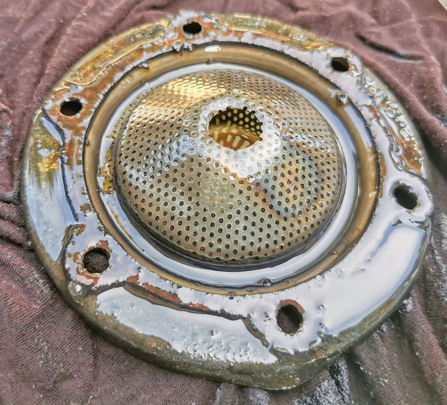

While I'd got the sump empty (again) I figured it wouldn't hurt to take a look at the sump strainer. I had been checking it religiously for the first few oil changes as quite a bit of sludge was initially washed out - but subsequent checks revealed nothing so I'd left it be for a while. Reckon it's probably been untouched for 650 miles or so now. Any slime present today?
Nope. Clean as a whistle (well, a very oily whistle...but you get the idea). The grainy looking bits at the far edge are attached to the gasket. No deposits in the basket at all.
I think with regular oil changes and the sort of driving I do I can probably drop pulling this out down the service interval list a bit. It's worth keeping an eye on, but definitely doesn't need to be pulled out with every oil change or anything like that from the looks of things.

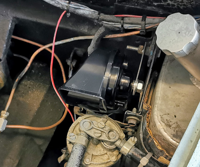

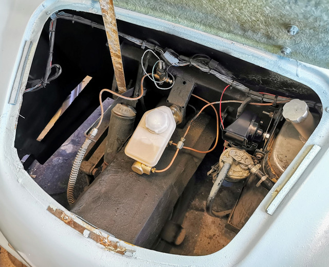

Later in the afternoon I found five minutes to fit the new horn properly.
Aside from needing to fit the proper foam pads in the fuel tank frame (which I do now have in stock at long last) it's *almost* looking vaguely orderly under here now...
The spare belt got in the way of the catch for the hatch so has been relocated to in a bag under the seat for now. I'm probably going to attach a couple of the down points for said bag on the fuel tank supports when I have them out to fit the anti vibration pads so it can stay up front, but somewhere actually out of the way.

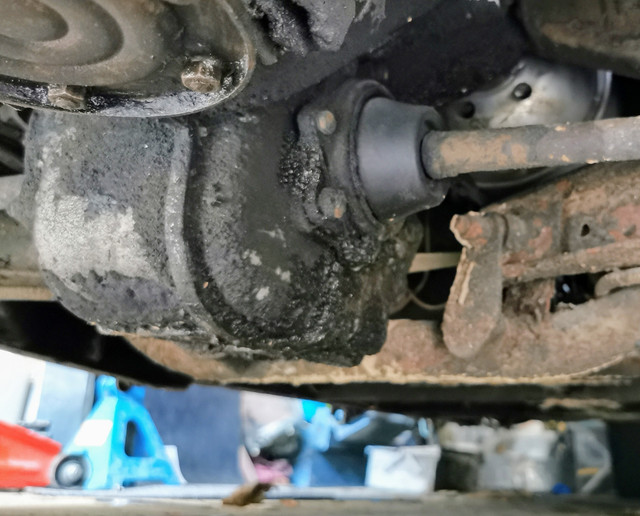

Though we definitely do have a weep from the diff on the offside, so I'll need to look into changing the driveshaft seal at some point. It doesn't seem to be enough to show on the level, just enough to make a horrible mess.
Level has never visibly dropped between checks. But it doesn't take much to make a huge mess. Given the state of the outside of the diff casing (I chipped of congealed mud and oil the best part of an inch thick when I had it out between cars) I'm guessing it's probably been like this for decades!

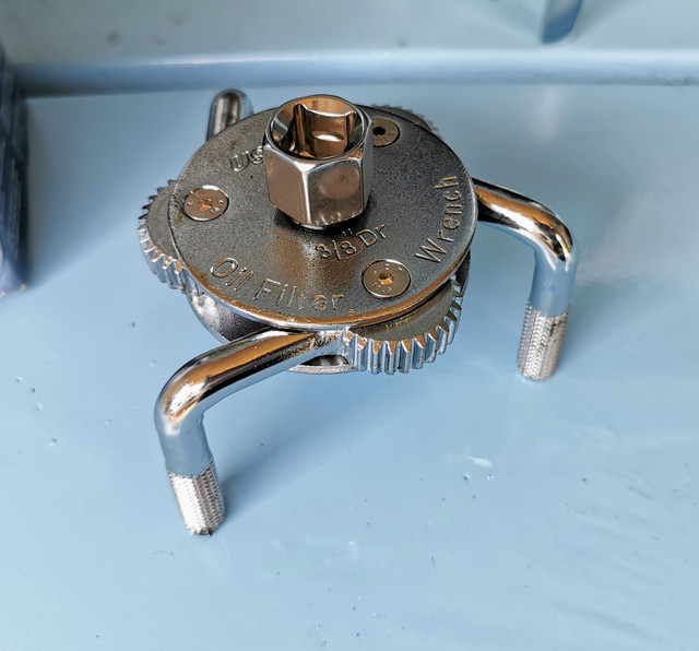

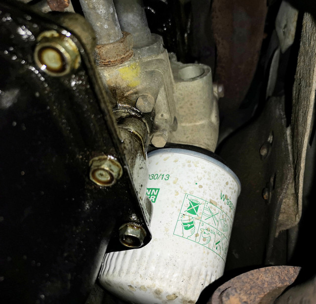

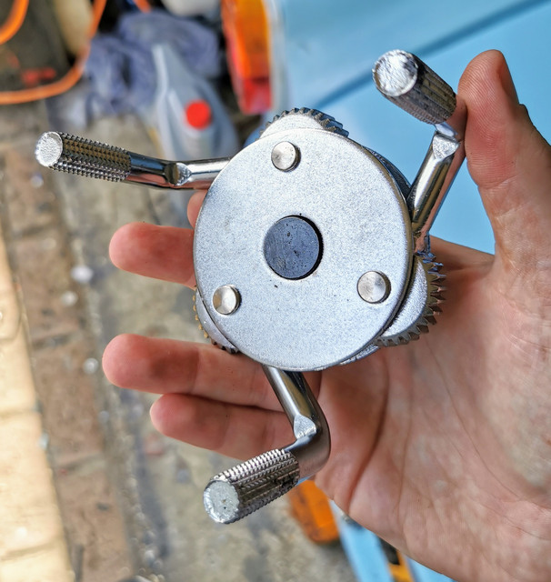

The Jag got an oil change a few days ago, but I found myself unable to get the oil filter off.
Quite HOW I managed to get it removed last time before buying one of these I have absolutely no idea.
The issue you have is that you only have access to what seems like the bottom few millimetres of the filter casing - and you can't even see it. Equally helpfully you're hard up against the nearside exhaust on one side, and it sits about 1/2" away from the side of the gearbox bell housing on the other so you really can't get your hand on it, and there's no room to get a strap wrench in.
Might be easier with the car on ramps, but with it on the ground it's a right faff. Especially as there's about an inch and a half of ground clearance on this thing.

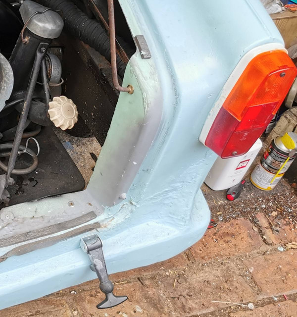

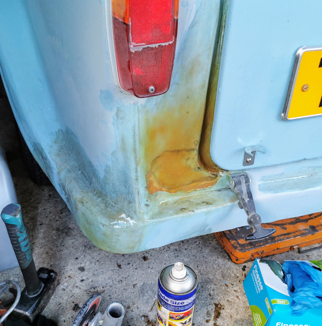

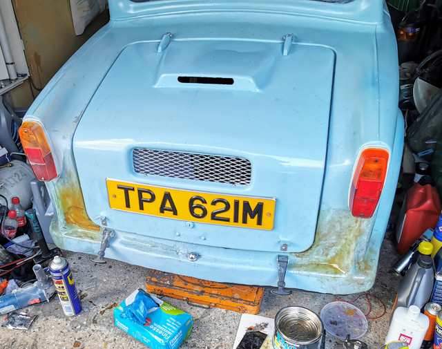

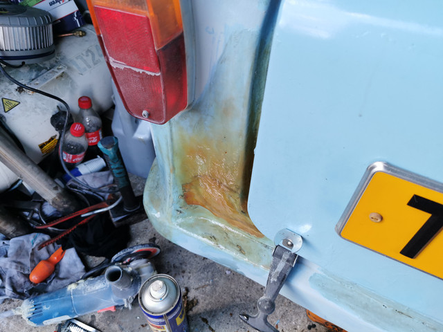

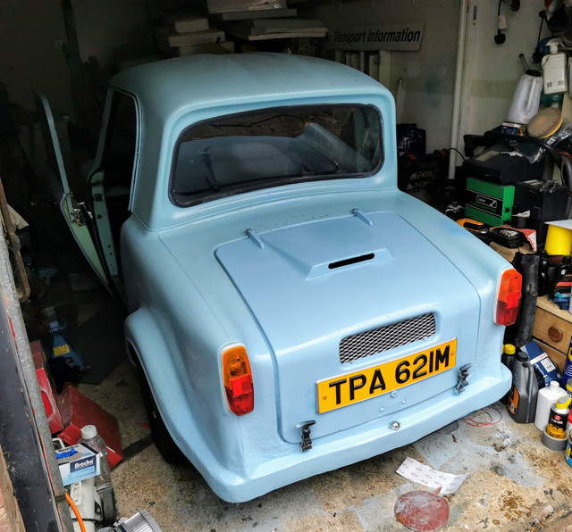

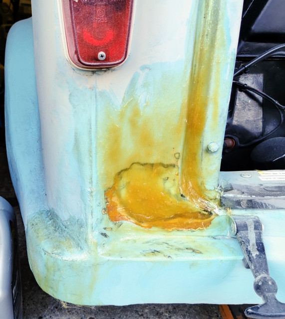

Last thing I did today was to address some remedial bodywork on the rear of TPA. I'd had issues with a crack appearing to the left of the engine cover, which was basically because I'd done an appalling job of getting the new glass fibre I had laid down to adhere to the underlying bodywork. Hopefully I've done a better job this time.
I've managed to get a lot smoother finish than I did last time - basically because I decided to ditch the applicator and form it by hand (wearing gloves obviously). This was WAY easier. I also used the excess left over to smooth over some of the horribly rough bits on the other side (this is where I started out rebuilding the rear apron so is where the fabrication was at its roughest).
Chuck a bit of paint on there after I've hit it with some sandpaper to knock off any high spots and it should look better I think.
Still be as rough as the North Sea in a hurricane, but better than it was.

Gibbo2286 wrote: 05 Apr 2021, 09:11 When applying body filler it's a good idea to use an old polythene carrier bag over it to smooth out the horrid stuff before it sets (iron it :) ) then just peel off the bag, saves a lot of sanding.
I did try that on one of the areas up front, but the bags just dissolved! Guessing that might be something to do with everything having to be biodegradable these days. Something I might need to revisit though as it would go a long way to dealing with the otherwise inevitable stray fibres which get dragged off whatever applicator implement you use.

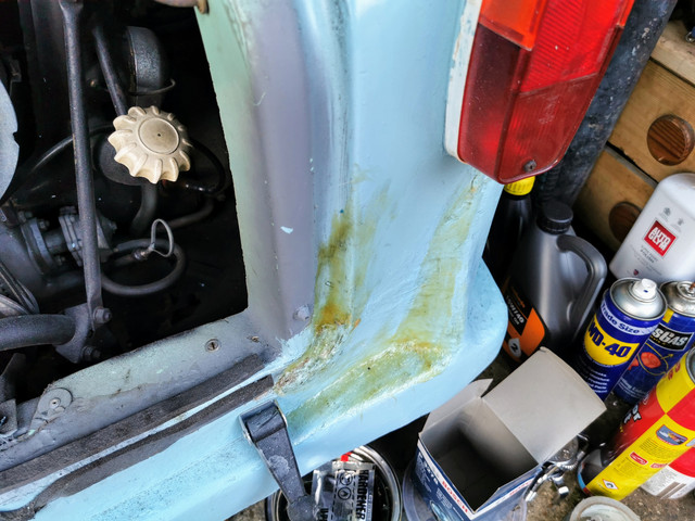

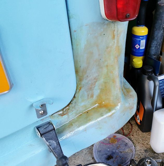

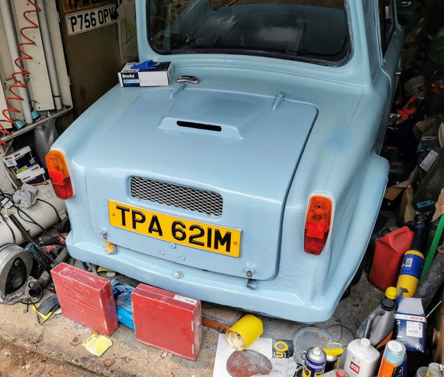

Some additional fibreglass and several coats of resin applied to the back of TPA. Bit of sanding obviously needed and it's never going to be (even close to) perfect, but should definitely be an improvement.
Even before I've done any sanding I think you can see how much smoother the finish is. Perfection isn't the target here, "presentable" is what I'm aiming for.

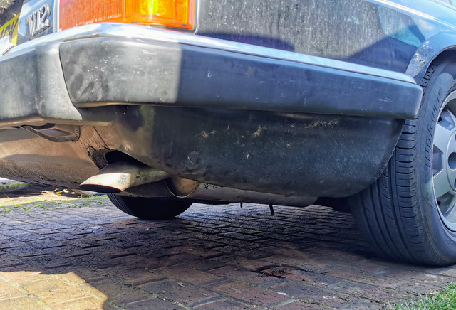

Yep, rear silencers are back on.
Definitely preferable...I must be getting older! Would prefer a bit more of an exhaust note, but for now I'll take refinement as a win.

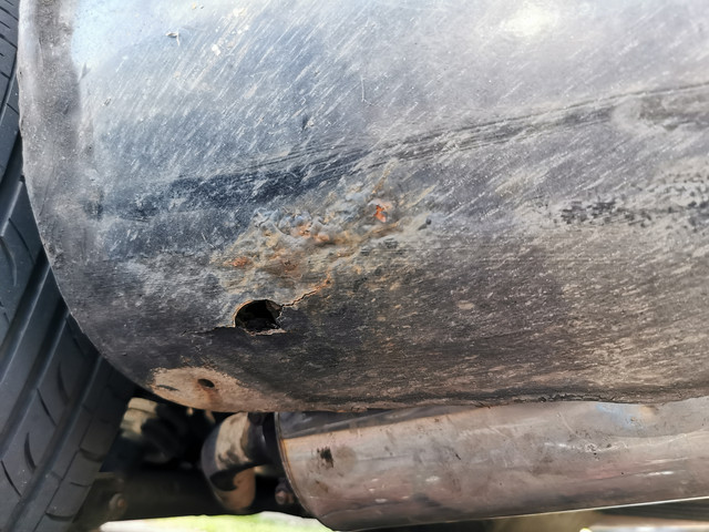

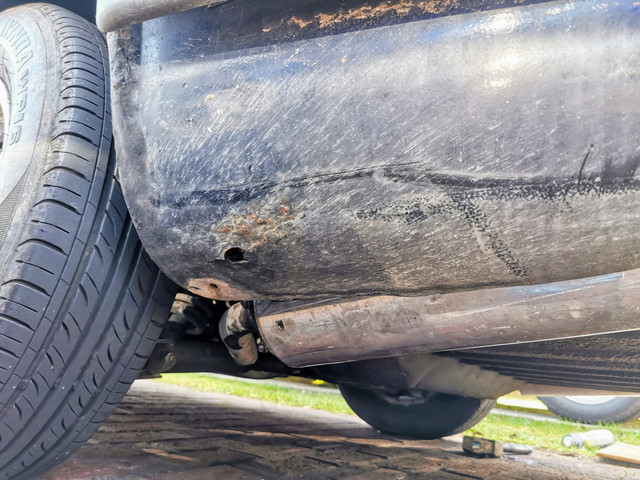

I just had to poke this rust scab didn't I?
Guess I'll be getting the welder out soon then.
I'll probably cut out more than I really need to, as hiding the seam under the bumper will be far easier than trying to flat my welds back to the point they're invisible! Plus this colour will be a pig to match.
I was expecting to find a hole there to be honest. Doesn't look like there's been any prior work there and we know the boot leaks like a sieve. Plus she's a 36 year old Jag, a bit of rust is something you just need to deal with, that's a pretty easy bit to deal with in the grand scheme of things.

Did a bit of sanding back today...and after about half an hour remembered precisely how little patience I have for that sort of thing and how much my back (which I'd already hacked off during a tip run earlier) hates it.
So quickly got to a stage of throwing my hands up in the air and saying "Sod it, that's good enough, throw some paint on it."
I didn't realise quite how much even this had improved things though until I looked at a couple of older photos though...
It'll do for now! Car has been in the garage without moving for long enough now. Plus I'm still planning somewhere down the line to A: Hopefully get some actual moulds made for the rear apron and B: Chuck it at a body shop to have a few things sorted out more professionally. So I'm not spending too long on this - dealing with the crack I'd had issues with on the nearside and keeping the car presentable from 30 paces is good enough for me.

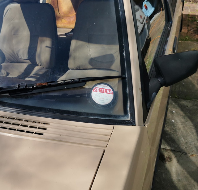

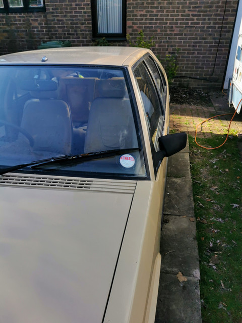

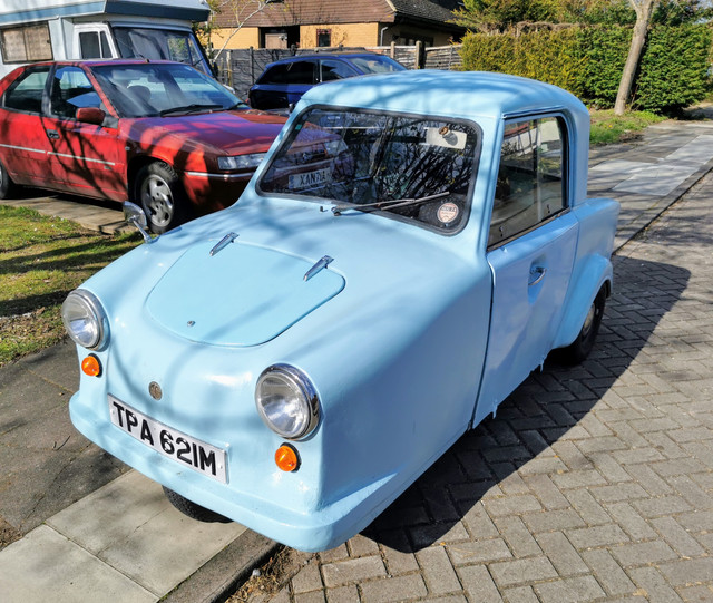

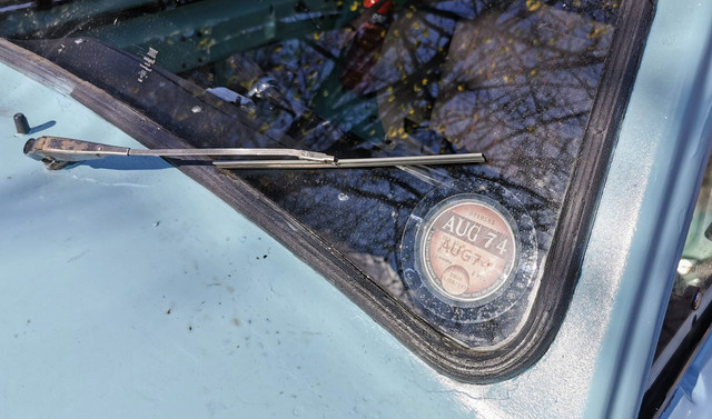

Had TPA out again yesterday. Now proudly displaying her replica tax disc.

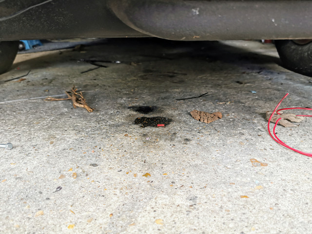

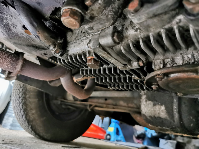

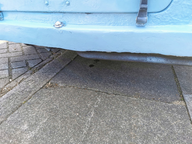

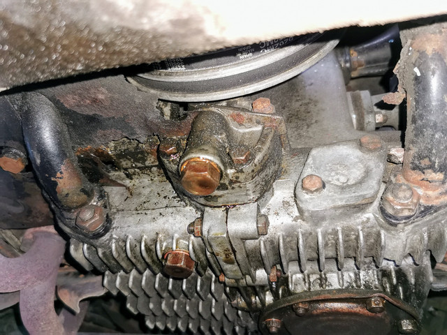

We're still leaking a bit of oil though I spotted when I came to put her back into the garage a few hours later.
Not a huge amount, just two single drips it looks like. However that's two drips too many for my liking.
I need to do a bit more detective work first but it looks like the culprit is the crankshaft oil seal.
Which would unfortunate as I'm pretty certain changing that will be an engine out job as I think the whole rear engine mount assembly will have to come off to get an impact driver onto it. I'll get a set of seals ordered anyway so they're in stock whenever I need them. If I do end up doing that I'll basically just replace every oil seal on the outside of the engine while it's out.
I'm not *too* worried about it at this point...I just want to keep an eye on it. With so little oil in the sump leaks are something not to be taken lightly though. If it is just a couple of drips when we stop I'm not going to panic though.

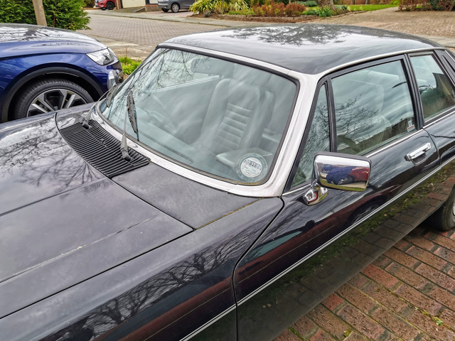

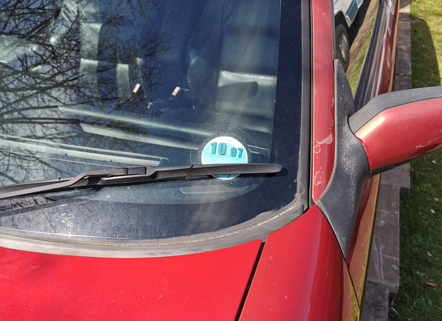

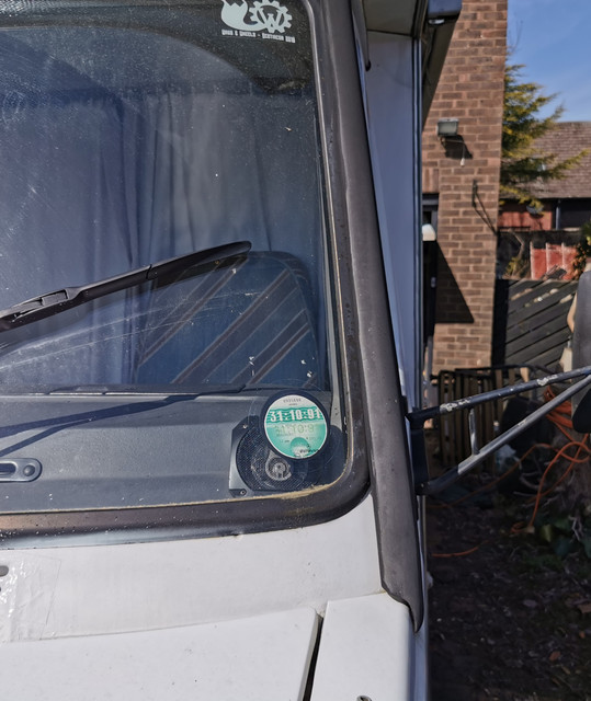

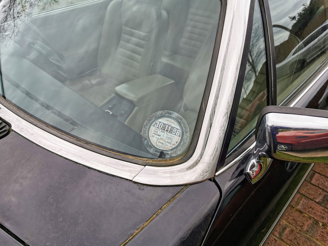

In addition to the replica tax disc in TPA, the rest of the fleet now have them too, thanks to Qarecar.com.

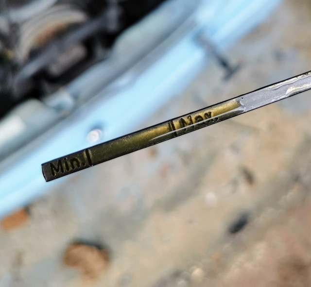

Well let's monitor the Invacar oil leak now I've resolved this.
Dumb mechanic error. Guessing I forgot to thread the dipstick in to take the reading. Let's see if this has sorted it next time we're out.

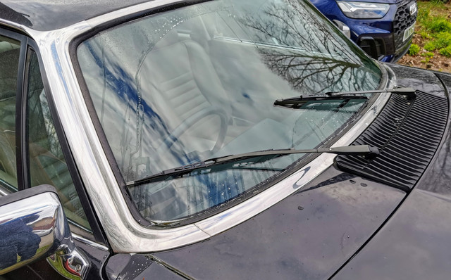

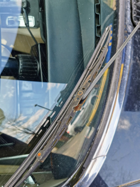

Only real car job was to finish sorting the wipers on the Jag. When I sorted out the intermittent motor back last year I never really put any effort into getting the wiper alignment right and had broken the non return valve for the windscreen washers. Both of these issues were resolved today, so the wipers now park in the correct spot again, so only a quarter of the way rather than halfway up the windscreen.
Replaced the wiper blades too as the ones on there looked horrible. They went rusty pretty much the day they were fitted.
Last job was to realign the washer jets as the driver's side one washed the scuttle and the passenger side one was pointing skywards.
