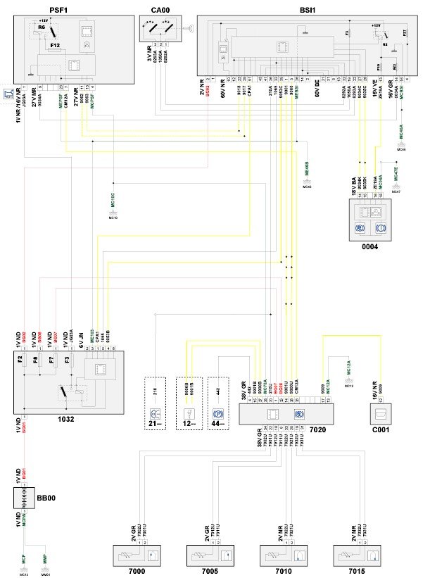

Hi all , is it possible to supply a wiring diagram for this dreaded nightmare please
Ian

I'll sort the correct one for the specific vehicle Wheeler with ESP:

Hi guys thanks , Marc would the components and wiring list be the same as you
Supplied for Mrtattoo .?
Ian
Ian
- x 6960
Re: c4 abs communicatin
Yes where the numbers are the same.
The components can be found on the wiki in ascending order in sections here:
https://frenchcarforum.co.uk/wiki/Elect ... ring_Codes
Here's the main ones for you:
