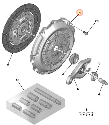

The Clutch mechanism is 2004AV
The Clutch Plate is 2055HT
Item (3) is 1611266780
Item (4) Clutch fork is 211766
Any other bits let us know.

Clutch kit is item 8 Marc...
08
2052 66
RP 16 112 692 80
01
01
CLUTCH KIT
An entirely sensible [NOT] £375 from Citroen. At least it looks like a solid flywheel!!

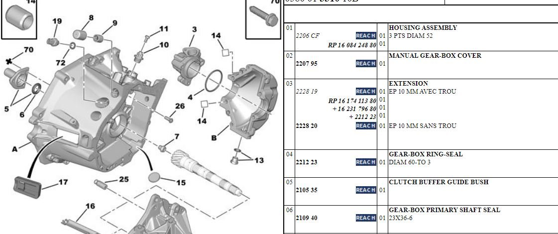

The release bearing guide sleeve / seal is item 5 above, very cheap, not worth not replacing.

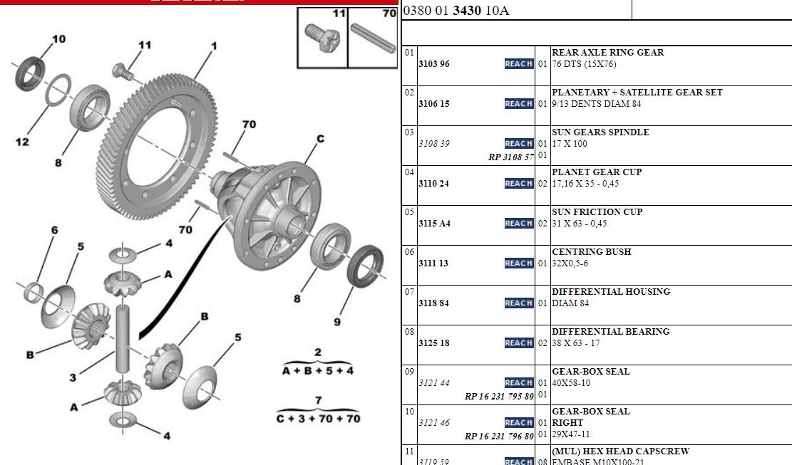

Driveshaft seals 9 and 10 in here
