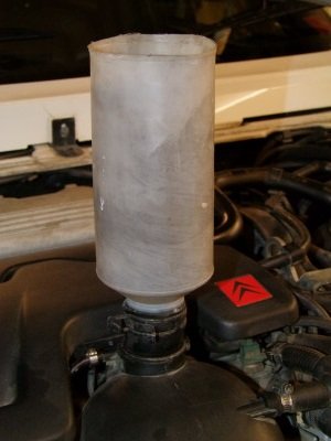

I’ve seen a drawing of the proper bleeding apparatus in the factory manual. It has like a bar that goes down to a radiator cap which pulls up and locks into place to allow water to enter and exit the apparatus.

Had a good chat with the diagnostics guy, at my mate's garage, who used to work for Citroen. I asked him about the proper tool.
Basically it is a radiator cap but without a spring on it and a plunger which lifts to allow water into the header tank and close to stop the water flow. There is a very good drawing of it in the factory manual. I'm going to make one someday.
The bleed point on the heater pipes is ridiculous. Unscrew it until you scald your fingers then try, in pain, to screw it back on again.
