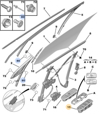

Right, before you start tearing the unit apart and cleaning it - have you fitted the correct part?
There are at least 15 versions of control panel on the X7, and will vary depending on saloon, estate, colour and various options fitted to the vehicle - specifically covering the different types of mirrors fitted. No amount of cleaning the contacts will help if the module is incorrect.
Do you have the original listing or part number you ordered for the replacement and then I can advise if you have the correct one?

Hi
I was waiting for the part number of the part you had previously bought as a replacement to compare it for you.
But the specific part you need for item (15) is part number: 6490Y4

Re: Citroen parts
These are not going to be widely available on the second hand market and you can only get new ones from Citroen.
They are currently priced £231.77 inc. VAT and you can order one from any Citroen dealership using the part number I provided.
So what was the original problem that led you to believe you needed it replaced?
If you still have the original, I would first look to cleaning that one up with some electrical cleaner and test it back on the vehicle before buying a new one. Otherwise if you can’t get it working and can’t find a second hand one, then the dealer is the only other place you can get one.
I suggest you return the replacement one to the seller if possible and say it is the wrong one so that you can reviver some costs.

The wing mirrors were intermittently not dipping down then the car was put into reverse and the actual window switches were very slack and didn't auto drop the windows on the front, basically they'd been fiddled with. I don't have the original switch(I stupidly threw it away before testing the replacement)GiveMeABreak wrote: ↑29 Mar 2021, 22:26 These are not going to be widely available on the second hand market and you can only get new ones from Citroen.
I feel I might be chasing the wrong faulty part? Could it be more a case of the motor's in the actual wing mirrors are faulty?
Cheers

Unfortunately, this particular model (like mine) is quite rare as it has the electro-chromed external mirrors and these were both indexable in reverse gear (part of one of the visibility packs with Xenon directional headlamps) - the later feature being removed and disabled shortly after 2009. So getting this specific control module may be a challenge.
@Estate87: The 'glitch' was a common issue in the indexable mirrors - sometimes they would work and other times they would lose their memory position. You should also be aware that a later BSI software update disabled the feature. It was down to some stupid EU rules concerning reversing and not seeing people at the rear if the mirror was indexed. Yet as usual, they completely disregarded the fact that the specific C5 X7 cars with this option all had reversing sensors (audio and visual) to detect rear objects, so that was a completely stupid thing to do.
I had mine reactivated after the function disappeared and I complained after the BSI was updated for another issue, but it was never quite the same afterwards annoyingly.
As for the windows, make sure you re-enabled the anti-pinch system. This is required if the battery has been disconnected and should be done on all windows and the sunroof if fitted.
1) Lower the window down completely
2) Using the first position of the window switch (i.e. don't use the one touch by pulling it all the way up), gently hold the switch at this first position so the window starts to close.
3) When it stops, which iyt will do multiple times, release and then again hold the switch at the first position to continue raising the window and repeat at each time it stops until it finally reaches the tiop.
4) When the wind gets to the top, then hold the switch at the first position for a few seconds. You may hear a faint click. This is the window anti pinch now initialised.
5) Repeat this on all other windows and sunroof if fitted.
\Not DOING SO CAN GIVE THE IMPRESSION THE WINDOWS ARE MALFUNCTION AS THEY CAN STOP LOWERING \
