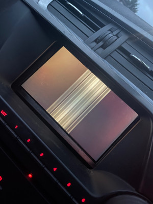

Hi everyone, ive got a 2013 Citroen ds5 and bought it February 2021 with a dodgy radio, when I mean dodgy I mean that the screen is black and has a few faded lines going horizontal but the radio worked, however it all stopped working about 4 month ago so I’ve had no radio no nothing for that long as I thought it would be an easy fix, I’ve tried looking at YouTube videos but no help whatsoever, has anyone found the problem to this? I’ve currently got everything my centre of my car in bits just to get the rt6 unit out as people was saying it could be the as card but I’m not sure

Re: DS5 radio intermittently crashing (sometimes)
This is what I get when car is turned on, just hoping that a new Sd card and a new firmware update does the trick
- x 6962
You may have a bigger problem going on here though - it may be the screen or the graphics chip in the head unit. So no guarantees. If you can't see what is going on when installing the firmware that is not going to help you very much, nor answering the questions when using Mira scripts to back up your user data files.
