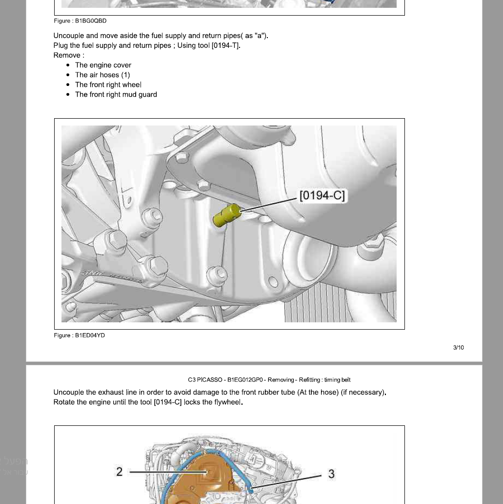

some thing i dont get , the manual said to insert tool(bolt to lock the flywheel , but after that it write to rotate the engine to specific point where the holes will line up.
how can u turn the engine if the flywheel is locked ?
it is neccesary to lock also the fly wheel
piki
- Posts: 129
- Joined: 27 Jul 2020, 17:33
- x 5
Re: picasso timing
nvm , i saw it said there to remove it after removing the pully

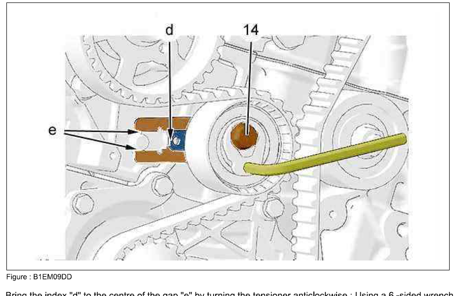

Re: picasso timing
how much tension does the belt suposed to have ?
i have like a 20-30 mm play in it ,after i set the tensnior in the center of the gap...
normal? , should be very tight?
