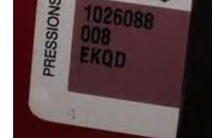

Do you have the directional Xenon lighting or the standard halogen lights? Putting you VIN up here (auto masked) will help us determine the exact car and options you have as the RP number and paint code is not useful.
