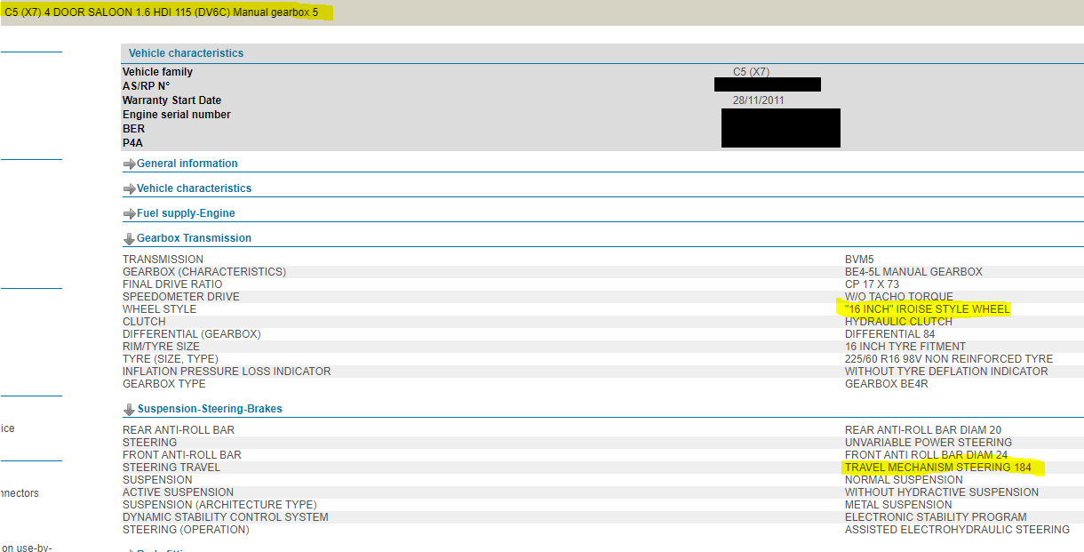

- x 6956
Re: Citroen C5 Tourer Exclusive (X7) Steering Rack reconditioning
No the 17" is also 180 ° - I've already looked it up from his VIN. It's the same as mine and I've had 3 of them.
And for information even some 16" wheels can have the 184 ° Travel . so it is really is down to engine and wheels fitted, hence VIN is needed to be sure.

- Posts: 9300
- x 1938
That is new information as the last time this was discussed I'm fairly sure the situation was as I posted.GiveMeABreak wrote: 19 Mar 2021, 10:09 No the 17" is also 180 ° - I've already looked it up from his VIN. It's the same as mine and I've had 3 of them.
- x 6956
It's why I always go by the VIN Paul - here as you can see an example
