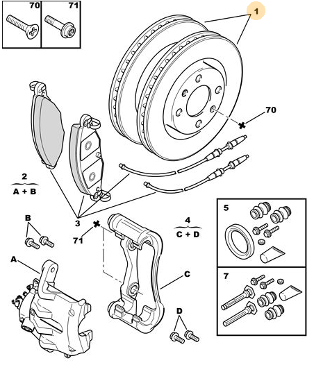

Hi - Could anyone tell me the correct disc size (283/26 or 288/28) for my 2004 C5 VTR 2.0hdi estate please? There are conflicting listings for the discs and calipers - some seem to use 288mm, some 283mm.

283 for the Fronts, 276 for the Rears.

Just for info:
The OEM Discs are part: 4249J6 (£138.52 for the 2 Disc Kit) and Citroen also do a cheaper version, part 1618862780 (£37.88 per disc), all inc. VAT direct from Citroen.
