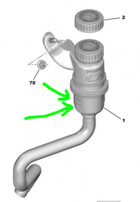

The fluid should only be filled between the 'A' & 'B' marks shown below:
The Fluid used must ONLY be Total LDS or Total Fluide DA.

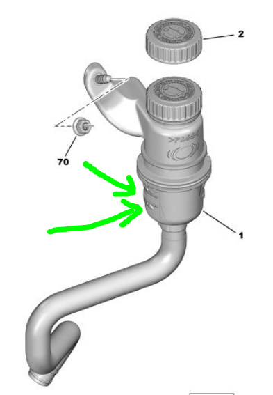

Ok, so just make sure it is filled to the max marking on the reservoir. In order to bleed, follow this:
Start the engine.
Turn on the engine and let it idle for 2 to 3 minutes, without moving the steering wheel (Top up with LDS if necessary).
Move the steering slowly, from stop to stop, in both directions, 10 or so times, with the wheels on the ground.
Do not hold the steering on the stop in order to prevent the opening of the pressure limiter.
Markings should be where I have arrowed
Start the engine.

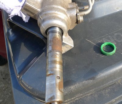

Hi all,
I've finally got round to sorting my steering rack that is leaking from the pinion shaft.
I'm trying to find out if its possible to replace that seal, and maybe buy what i understand to be an added part (the green thingy) in the pic below
thanks in advance
thanks in advance
- Attachments
- Posts: 6846
- x 3566
Re: Citroen c5 power steering fluid
I wouldn't bother with the green ring, it's somewhat pointless. The seals are easy to get, IIRC they're just standard 'O' ring seals, but replace them with twin lip seals if you can. I think I covered them and their measurements in one of my previous posts regarding the steering rack components. You'd have to get the pinion shaft spotless and smooth before wanting to put new seals in though, and that's the tricky bit as it'll probably be pitted now. The best protection would be to coat the exposed lower part of the shaft in Denso tape / epoxy coating / anything that'll slow down the rust as well as doing the protective boot mod.
- x 6954
That may be insufficient if the rust on the pinion has penetrated further down the shaft, underneath causing the seal to deform. If rust has entered the internals, then a rebuild is likely to be needed. Citroen don't sell the seal or the green plastic ring - so you'll have to source the seals externally. A replacement rack that has been refurbished and treated is probably the best way to go.

hi all steering rack as been removed and pinion shaft is a little rusty but no excessive rust around the seal.
ive been searching for a seal to replace the old one, but i have only found the pipe seals, that i have purchased as while they are off i may as well replace them.
Does any one know where i can get the pinion shaft seal from.
bobins all ready mentioned the twin lip ones but i cant find the post about sizes that he referred to or where to get them from.
cheers craig
