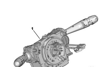

What actual parts did you replace? If you also replaced the Com 2008 unit inside the steering wheel (that holds all the lighting and wiper stalks), then that may be one reason, as these are different depending on features and options as well as build date. This is important as some units were hands free starting and some weren't and these had different com units.

That's why I asked you exactly what has been replaced. The electronic module behind the steering wheel is specific to the vehicle and is responsible for handling the immobiliser data and communicating this to the BSI. SO if you have replaced that unit, it may be the incorrect one for your vehicle.
Example this is the unit I am talking about:

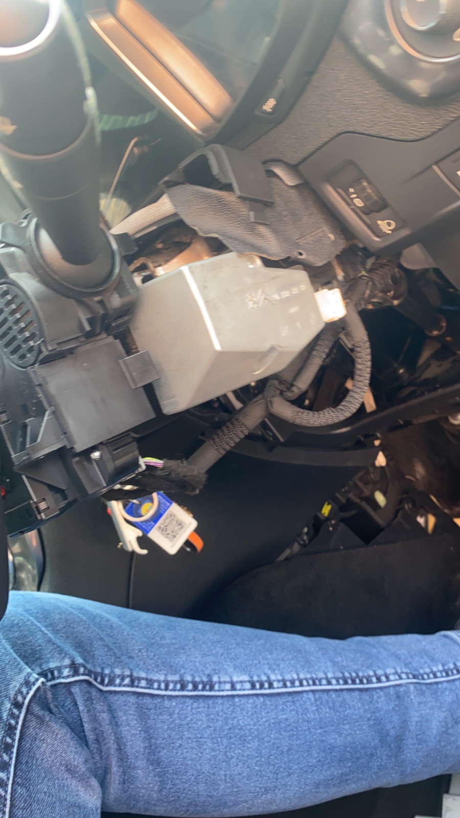

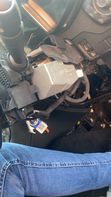

Only this , after i was put my one but immo was block any chance to unblock by lexia diagbox i was ordered from ebay or enyone can help

That grey box is the electronic immobiliser that locks the steering wheel. If it is removed and refitted it needs re-programming.

was sorted.. needed new electric wheel steering lock from dealer , can be programmed once .
