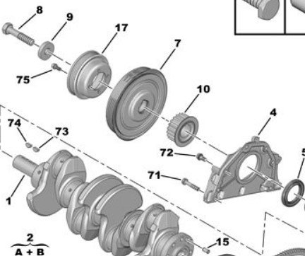

Yes, realise that is the later one, but here's the part diagram showing the second pulley on a Mk2 2.0 HDi with AC (17), it even shows as 4 groove, and there are four bolts, so it looks pretty much identical to the later one..
As you say, a pic of the engine will reveal all!!

It definitely looks like the diagram in the previous reponse, although my van doesn't have AC so I don't know what the belt at (17) is for.
The VIN number is VF7**************[VIN obfuscated, can be read by forum staff].

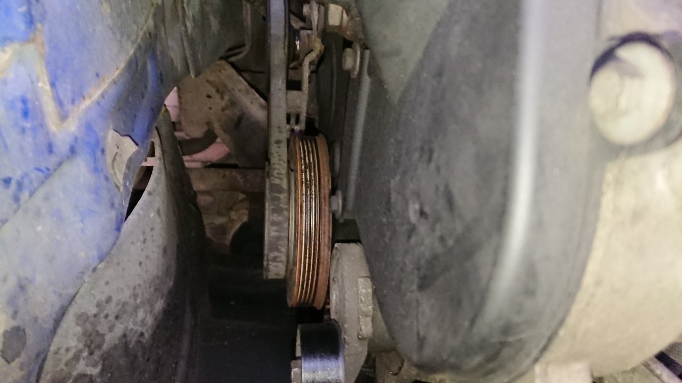

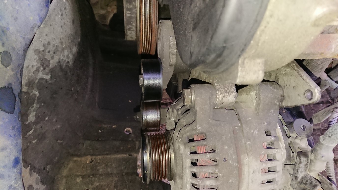

It looks like a power steering pump & it looks like you can seen the manual adjustment bolt in the first pic. You neen to slacken the pump mounting bolts a turn or two then screw the adjustment bolt to loosen & tighten the belt.

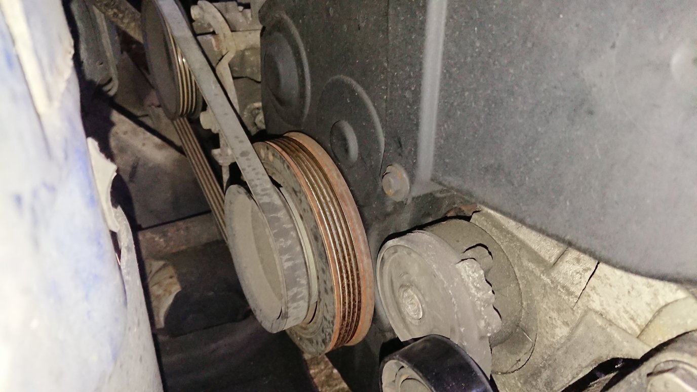

However I've loosened both the bolts - bolt 1 on the picture I've loosened 12 quarter turns, and bolt 2 a half dozen turns til it was loose - but can't figure out how to get the pump to move in order to get the belt off.

You may also need to slacken the bolts that the pump pivots on, they will probably be accessed through the holes in the pulley. Once you slacken the adjustment nut try pulling down on the belt & this should pull the pump inwards to slacken the belt.

One of the 2 pivot bolts was completely chewed out, but I managed to get around that by undoing the pulley on the crankshaft end.
A lot of work to get the alternator tension pulley into the slack position, but once I got it the belt went on fine with a little slip from a screwdriver.
