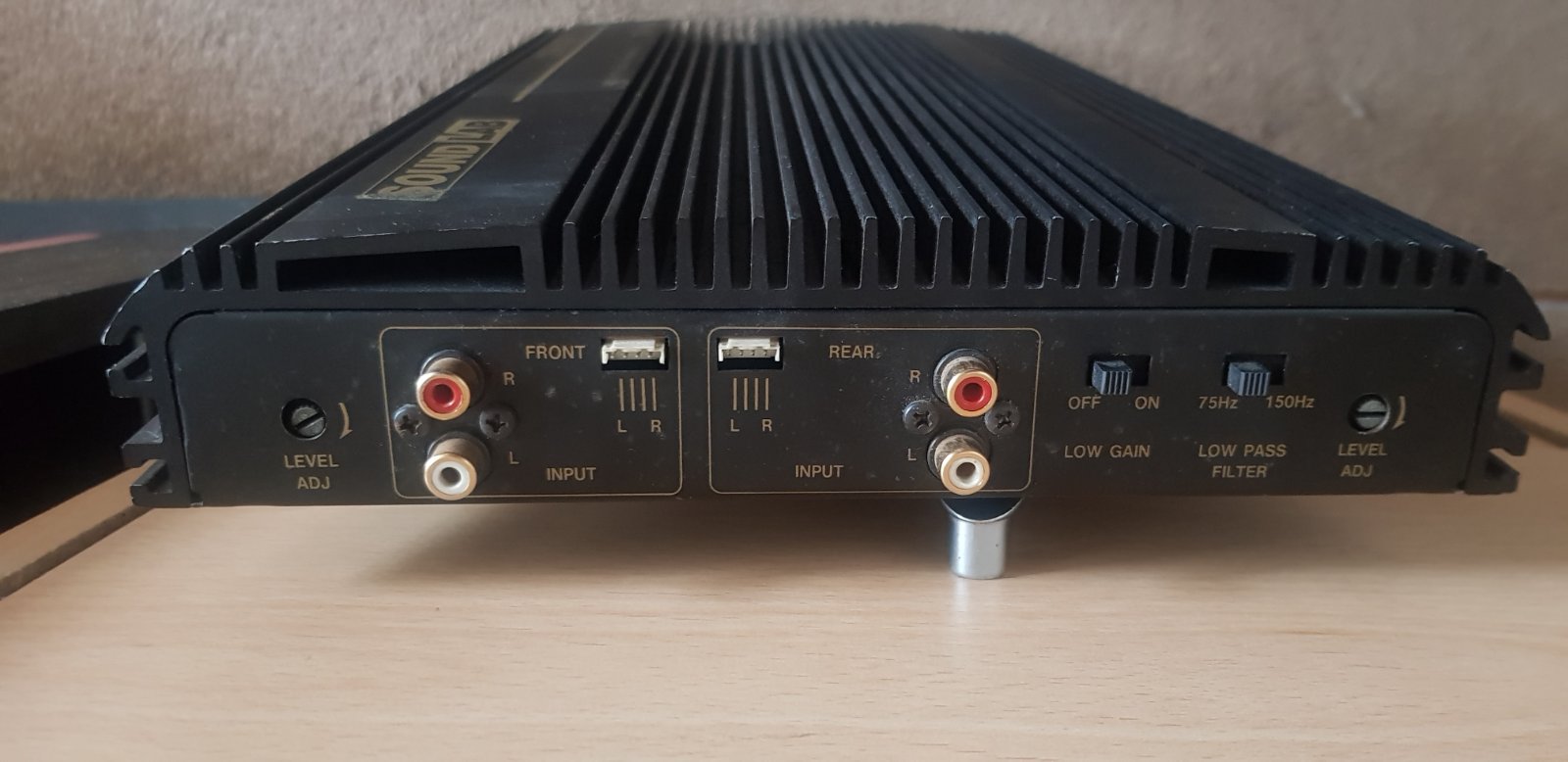

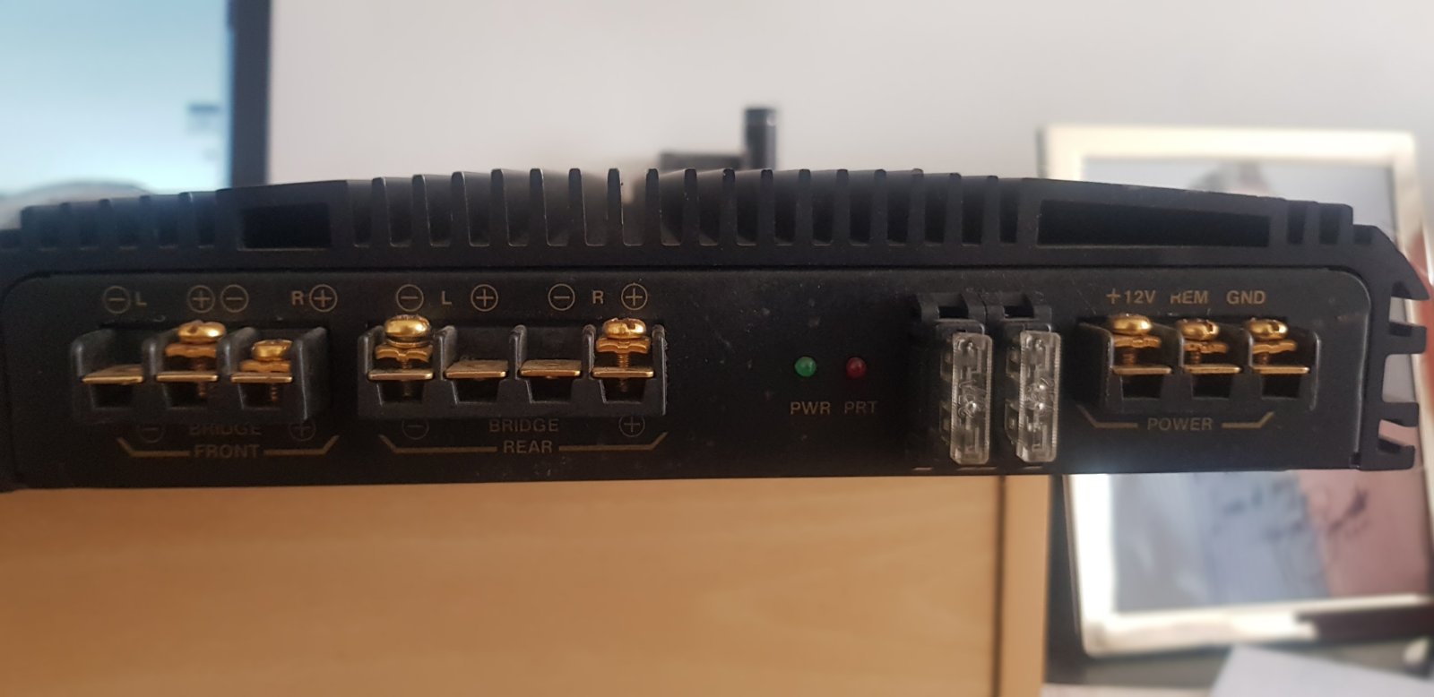

The amp i have is a Soundlab cpa 504n which is a 4ch unit, whilst it was on my xantia it benefitted from being connected to the sony head unit via 2 rca outputs and had it's own direct battery feed (fused) as well as a switched on/off signal wire. As i understand an Amp needs a low input from a head unit as they generally cant handle a high input & the amp then converts this to a high (AC) output to drive whatever, in my case a single sub'. This is why i need a line out connector (LOC) which is what that item is but with no obvious connection to any speaker output i don't see how it could work & the sub will still need a main battery feed.

Each setup is going to be different depending on equipment of course, but yes, line level outputs are generally what is needed to convert the high speaker output from the head unit to low level input that the amp can use and then from there, the output connections from the Amp go to the speakers. You obviously need to ensure that your max RMS output of the speakers in the car can handle the RMS output from the Amp though or you'll likely blow them.
If you have a 4 Channel Amp, then that is usually to drive the 2 front and 2 rear speakers, but these can be used to run a pair of speakers and a subwoofer, with 2 channels bridged together to run the sub and the other two to drive the speakers.
Obviously you will need the line converters for the input if this unit does not already convert the inputs internally (unlikely for the year) and you'll have to connect the speakers / subwoofer to the Amplifier output and run a separate power feed for the Subwoofer.

The amplifier won't be used to power any of the car factory speakers, at least not for a long long time as there's too many other jobs that the car needs before that. The job of this amp is purely for powering the sub.
I actually got this amp off a mate i worked with who sadly passed away some years ago & so although it's not ideal for the job, it's kind of overkill i partly keep it in memory of him & it replaced the kenwood amp that originally came with the sub.

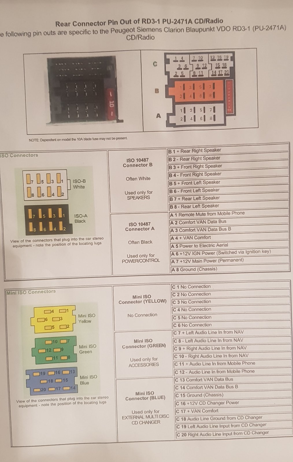

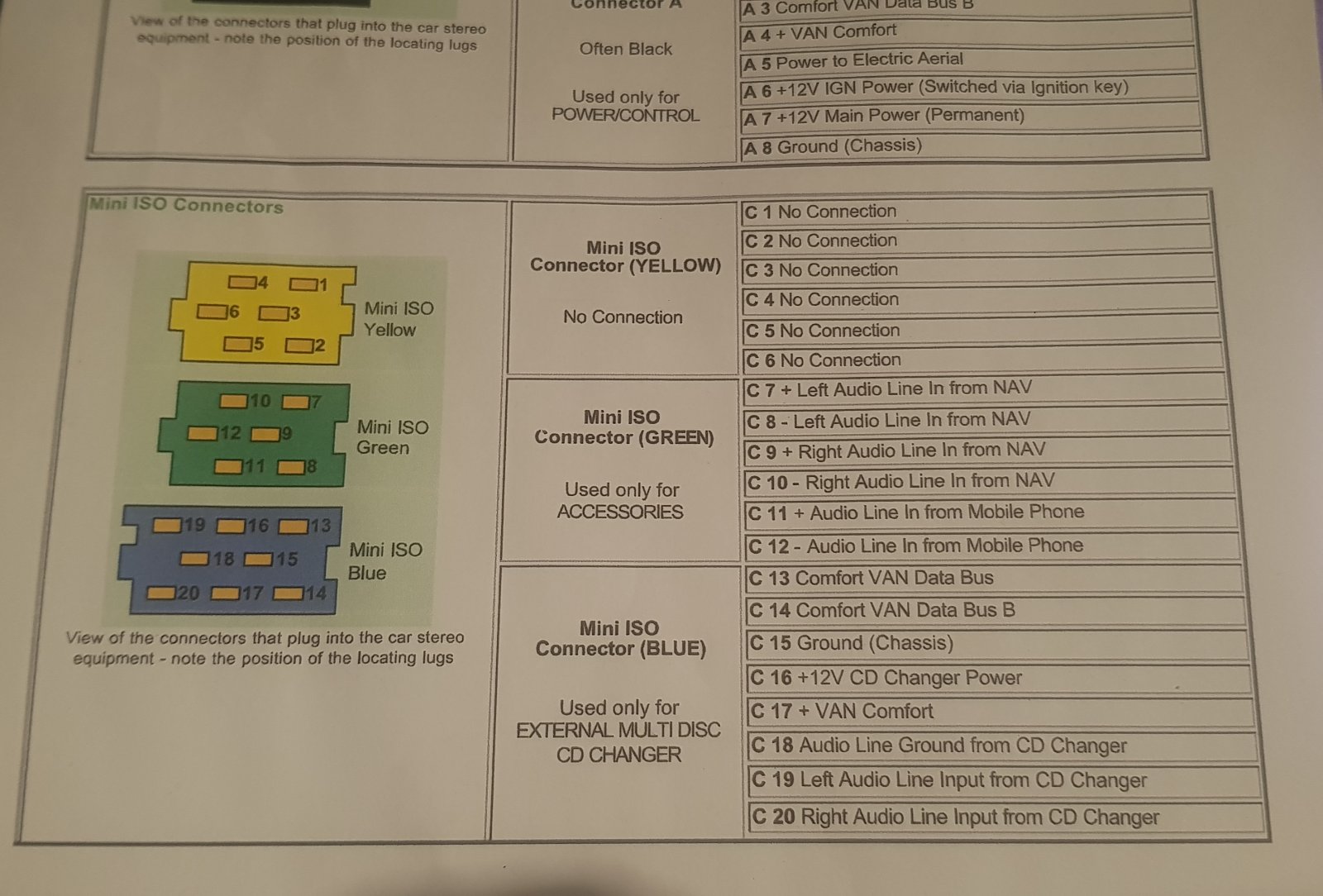

As for the yellow iso connector, i sent a audio dealer a message on ebay asking if they thought it would work but looking at the wiring diagram i provided they were sceptical and suggested the green plug might actually work better but that doesnt have an earth out or switched amp feed so i might be back to the start and looking at a conventional LOC although i dont really want to be splicing into the factory (CAN) speaker wiring.

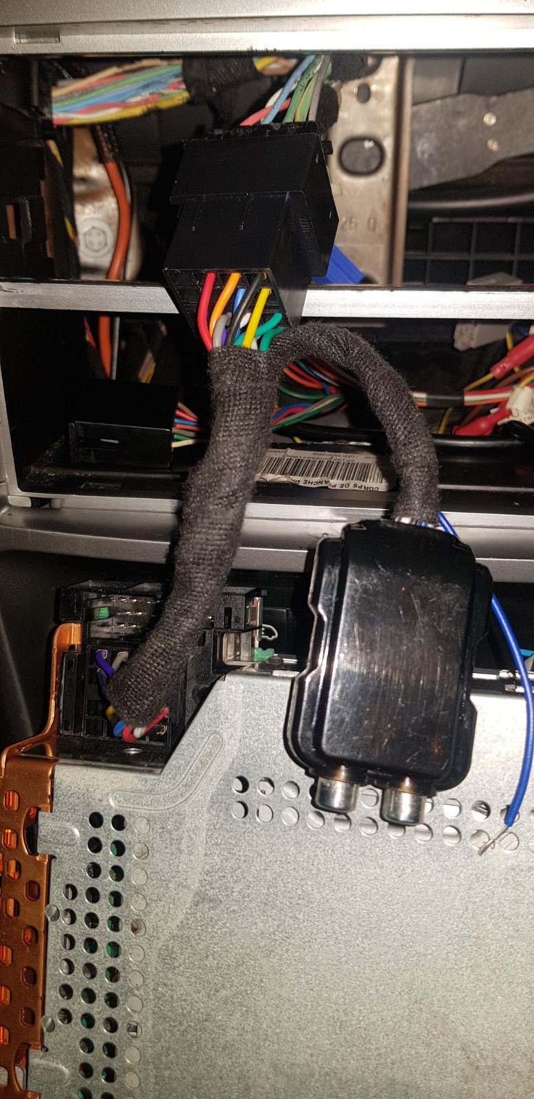

Having now tried two different types of 'Vibe' Line Out Connectors of which neither have worked i've pretty much given up on them and im looking to get something else that will do the job. It came to my attention today that the (yellow) mini iso plug/port is often referred to as 'line out' on a fair few wiring diagrams i've come across on the internet and i was wondering if something like this https://www.ebay.co.uk/itm/Car-audio-IS ... 3267572809 could be used to power the amp. It looks too good and too simple 'a solution to work, anyone any idea's?. I tested each terminal in the mini iso port and only pin4 had any power coming from it with the radio on. Unfortunately for what ever reason the amplifier no longer seems to be working, it was fine in my old car running off the Sony's rca ports but now it goes into protection mode whenever i connect it to the new cars wiring (via this Vibe LOC) so it maybe damaged, i've given it a direct feed off of the battery and it came to life once but the rest of the time the (red) protection light illuminates very dimly. I have ordered a replacement amp (2nd hand) but obviously i don't wish to connect this up and risk damaging that too, i will also be making an appointment with a local audio specialist asap. Any idea's and thoughts would be much appreciated.

After a lot of messing around i'm hoping the amplifier issue is now finally sorted, i tried various connectors such as mini iso plugs and LOC's of which i suspect damaged my amplifier so i had to go out and buy another, this has now been fitted using a conventional LOC device wired into a speaker extension loom (rather than directly into the car harness) and so far the amp/sub and Yatour device all work together, all i've got to do now is fix the multifunction display so i can see what i'm listening to (not a bulb issue, faulty screen problem
