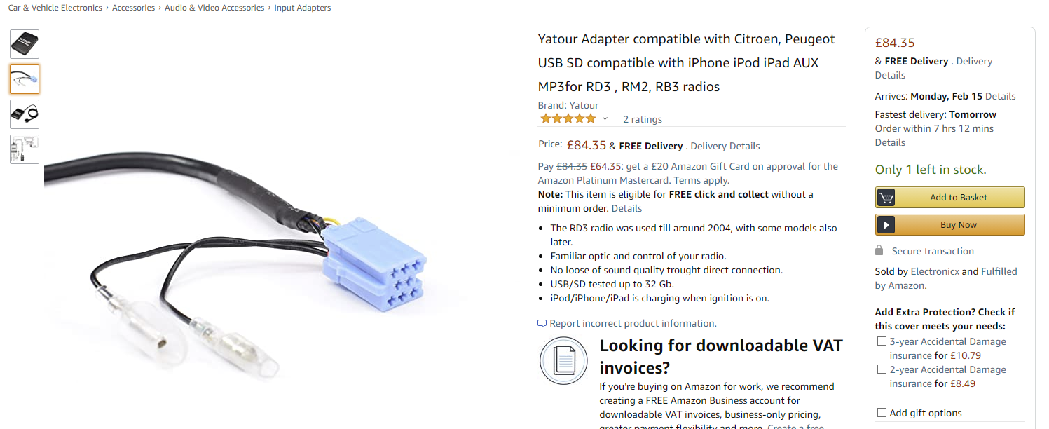

Have a look at this:
https://www.amazon.co.uk/iPhone-adapter ... rel&sr=1-1

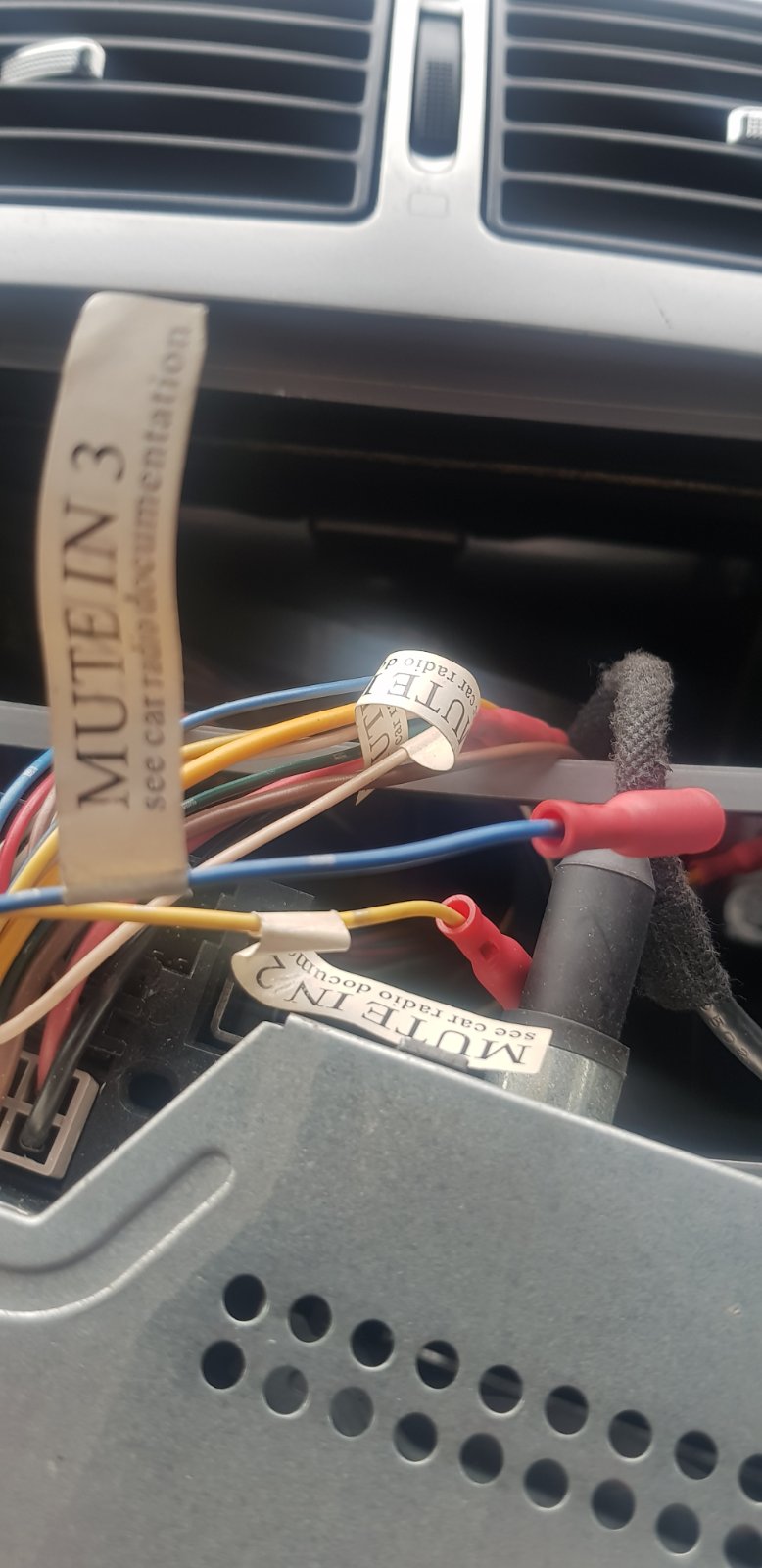

I forgot to mention this car also has a Parrot phone device fitted, I've no idea how they work but i suspect its connected into the cars wiring, I'm likely to bin it to be honest.
Possible wiring for Parrot device?

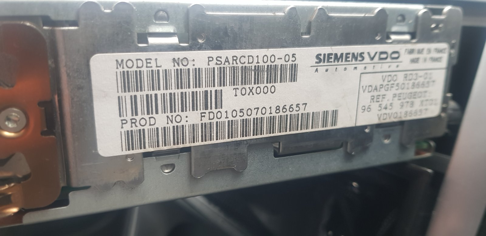

Yes, understand about the Sony head unit and the steering controls - that's just a matter of converting the steering wheel control interface to match the Sony unit - which already has Jack, USB and whatever else built in. But here, you're using a limited Head Unit without any of these external audio capabilities or features apart from a CD / CD Changer, so it won't matter what connection you have to it, as it's not designed to handle external media or control it.
So the Yatour just acts as an intermediary to accept a USB, Media card etc and passes the audio output to the Head Unit. Because the Yatour is pretending to be a CD changer it mimics the 6 folder system of the CD changer that the Head Unit recognises. So you can fill up each of the 6 folders on a USB stick with music files and the steering wheel controls will play, skip, FF RWD tracks etc.
So back to your system, I can confirm it is a VDO RD3 system - so if you do go for something like that Yatour, make sure it mentions RD3 like the one in the link I gave you to be sure it works.

The one you posted a link to from amazon is listed as not available unfortunately, i've had a look on eBay too & whilst Yatour do them for the rd3 unit they don't do them for the rd3-01. I may have to look at other brands. If i can get something suitable it will no doubt run off the RD3's CD changer socket on the back of the unit so unfortunately that will mean i cannot make use of mick's CD changer.

It's the same - as long as it says RD3 you will be fine.
That link still shows as available:

Thats weird that is showed up as not available to me previously, unfortunately i don't think this will work with my phone as it's Android.

Bluetooth is not OS or phone specific. That system was just an example.
