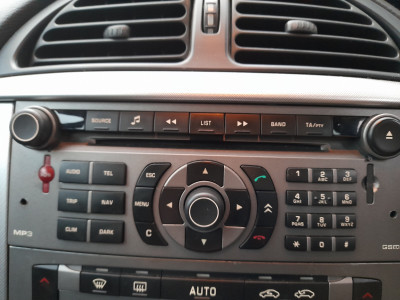

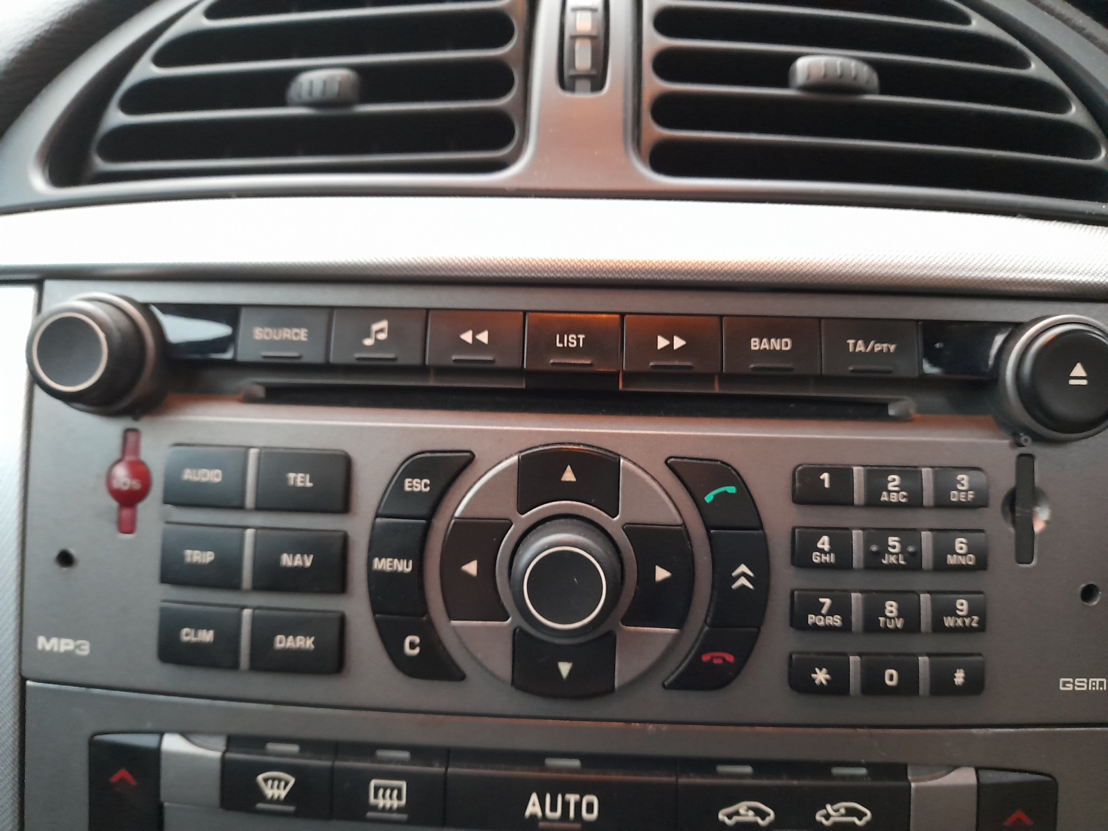

Hi,
I would be very grateful for any advice with regard to getting my C5 2007 radio satnav working again. I have looked through old posts on this site and elsewhere but can’t quite get the answers I need.
A few weeks ago it started displaying the “insert upgrade CD“. I had a look online and saw a number of different suggestions. So far I have tried...
.. disconnecting the car battery for two minutes then reconnecting - no effect
.. disconnecting the radio satnav for 24 hours then reconnecting- no effect
.. holding down the DARK button for a while - seems to try to reboot and then show the same message
.. holding down the MENU button for a while - does nothing at all.
..I used my basic OBD reader to check for any fault codes on the car and there weren’t any.
.. I bought an upgrade CD with from a well rated seller on eBay - when I inserted this I could hear whirring noises as though it was trying to read the CD for about 20 seconds, it would then eject the CD and after about 10 seconds would reload it all over again. I left it doing this for about half an hour but there was no on screen progress i.e. the screen sometimes went black when it appeared to try to reboot and then just showed the insert upgrade message again.
.. after reading that the copy CDs are sometimes faulty, I went to Citroen and bought a genuine CD but this only did the same as the copy.
.. I contacted a reasonably well-known car stereo repairer which advertised that it could repair the RT4 model and asked them what they might charge to repair the hard disk if that was at fault. They told me it was extremely unlikely that it was the hard drive but whatever the problem it was likely to cost several hundred pounds.
.. I have looked online to see about buying a direct replacement and it seems as though these are not commonly available now, but if they are, come in the at about £200 without a guarantee.
.. I don’t tend to use the RT4 satnav and the telephone function is a bit hit and miss as it often can’t recognise the Sim card which I assume is down to the Sim card holder as I have tried other SIM cards and so looked at downgrading to a cheaper secondhand replacement but I am not sure if they have the same fixing points into the dashboard and they seem to have a different aerial connection.
...... sorry for the long ramble of all that I’ve done but I thought it was easier to run through that than have people being helpful offering some suggestions that I’ve already tried.
My questions are firstly, am I right in thinking that the problem is likely to be the HDD, and if so any ideas where I might get one or an alternative to the original Hitachi Endurastar which wouldn’t require any prior formatting etc? Is it fairly simple to fit the hard drive or is it likely to require special equipment etc (I have previously fitted HDD’s in laptops which was very straightforward)
Secondly, if it’s going to be difficult or complicated to repair, are there any simple plug-in alternatives such as a secondhand RT3 unit- would this require a an adapter for the aerial for example?
Thank you very much in advance for any help anyone can give.

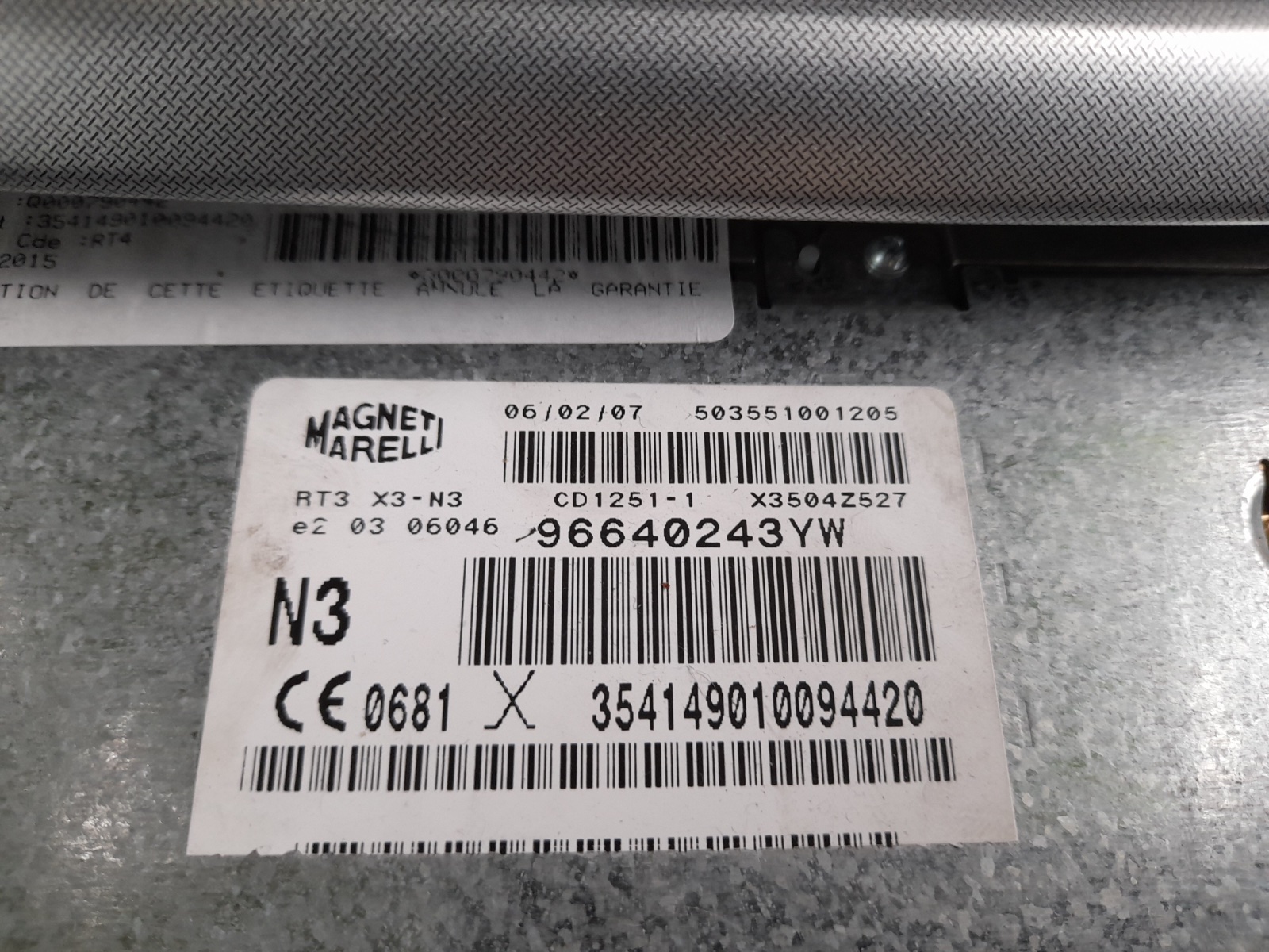

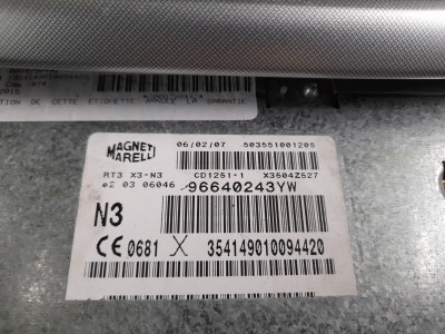

Hi Marc, I have fitted the replacement stereo head unit which I was told comes from a C5 with the VIN —. VF7**************[VIN obfuscated, can be read by forum staff]
My car has the VIN —. VF7**************[VIN obfuscated, can be read by forum staff]
I have spoken to John ( jgra1 ) and he has kindly agreed to use his Lexia to see if he can restore full function.
Currently the new unit makes a very loud beeping every time I try to use any function that has audio eg sat nav or radio and it doesn’t swap between audio sources either on the unit or on the steering column stalk. Other than that though it’s a big improvement already to have the display back.
Many thanks for any further information you can provide on this and any suggestions as to any particular areas on the Lexia menu that we should be looking in.
Graeme
Graeme

That beeping is because it hasn't been VIN coded to your vehicle and will remain until it has.
Ok, so I've checked all the specs and although yours is a 2.2 and the other one is 1.6, the options are the same regarding parking and lighting etc., so should be nothing else to configure apart from the VIN coding.
