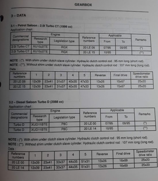

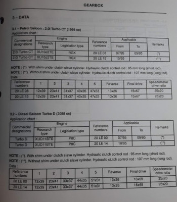

I've dug out some ML5 gearbox ratio data I have Roger... Especially for you I visited my attic and dug through a load of manuals
Not for the HDi specifically but I know the HDi ratios are the same as the 2.1TD ratios except the final drive is a tooth or so higher...
Hope this helps a little to see how accurate the rev. counter is but do remember S2 speedos are a bit optimistic too

Thanks ever so much Jim.CitroJim wrote: 03 Mar 2021, 09:21 I've dug out some ML5 gearbox ratio data I have Roger... Especially for you I visited my attic and dug through a load of manuals
I was expecting to see ratios not the number of teeth too! Will make for an interesting exercise. I first look at it and thought, "What the hell? That's of no use!" but it's hopefully fairly obvious. Just like bike gear ratios. I'll let you know the inch gears...

Re: Xantia 2.0HDi - Rev Counter idles at 2000rpm.
On 195/65/15 tyres:-
The 2.1TD develops 28.35mph per 1000rpm.
If the final drive ratio is 17x69 then it would develop 30.11mph per 1000rpm.
And if 18x69 then it would develop 31.89mph per 1000rpm.
30mph in 3rd would be either:-
1952rpm on a 2.1TD or,
1837rpm with a 17x69 final drive or,
1735rpm with a 18x69 final drive ratio.
