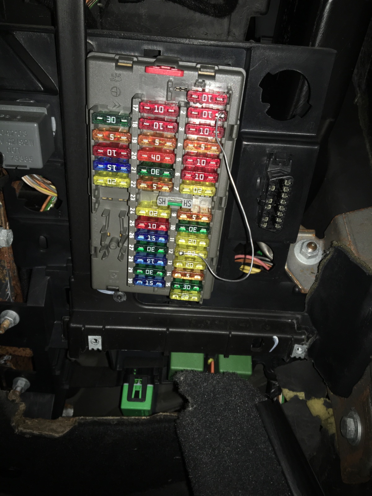

OK.
So Lexia is giving some temp faults which do not concern me.
However, when I come to try and erase those faults I get the message “Communication Problem” and it will not allow erasure.
I’ve checked for power to the fuses and there is none on some.
I’ve then hot-wired from the battery to F12 and all dash lights illuminate and the car starts.
So now it’s time for a nice cup of tea before trying to trace the offending wire!

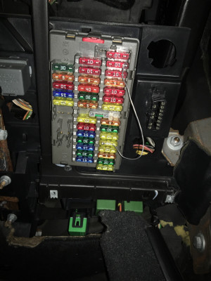

All done!
Temp fix for now.
I’ve only got factory manual for S1 bumper removal. Not sure if S2 is the same protocol.
Thanks for all your help guys.
Made up that I got it sorted in a day.
Temp fix for now.
