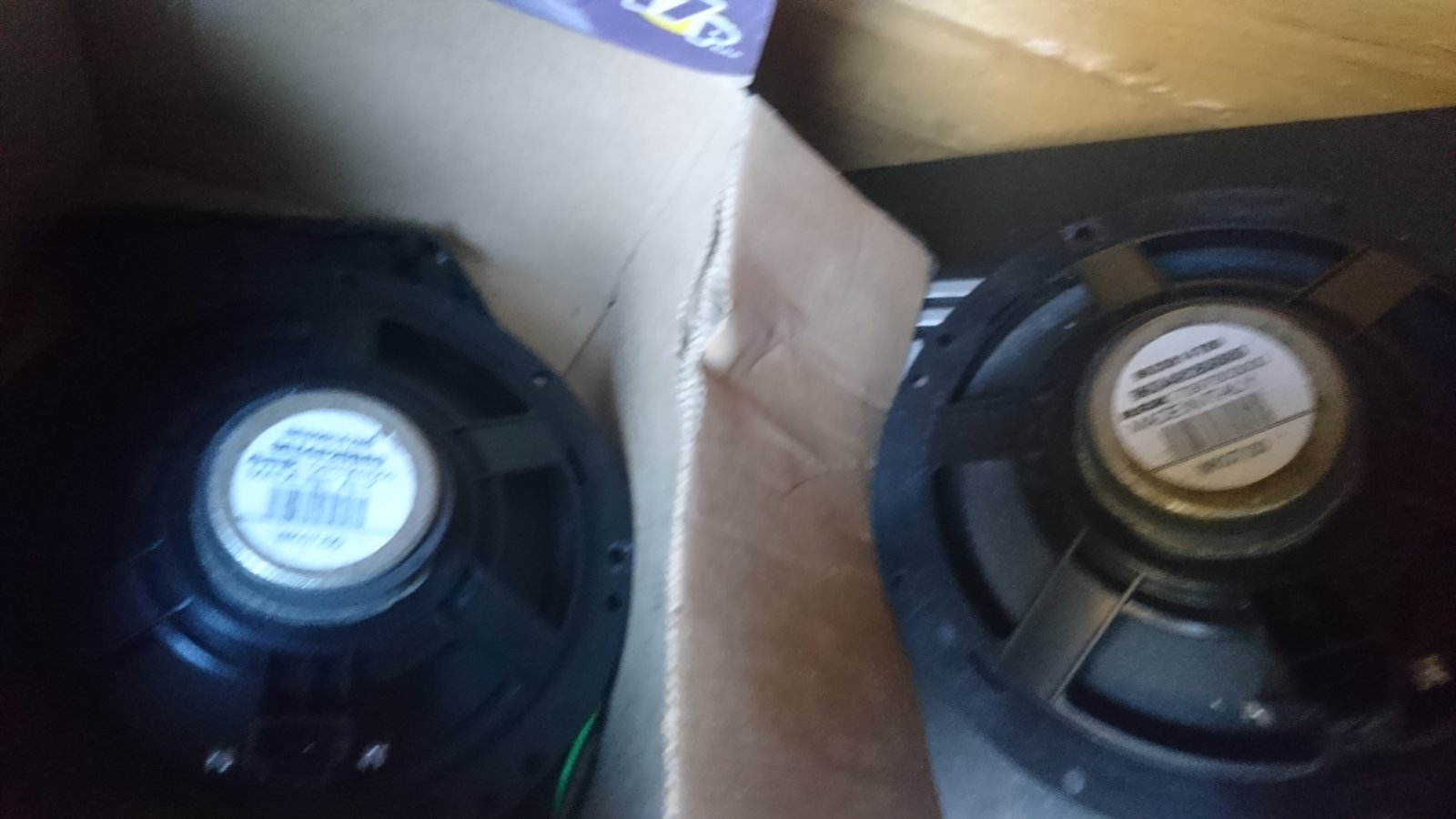

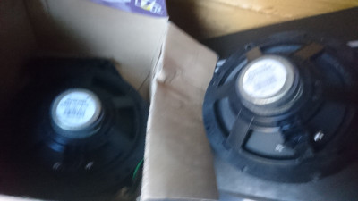

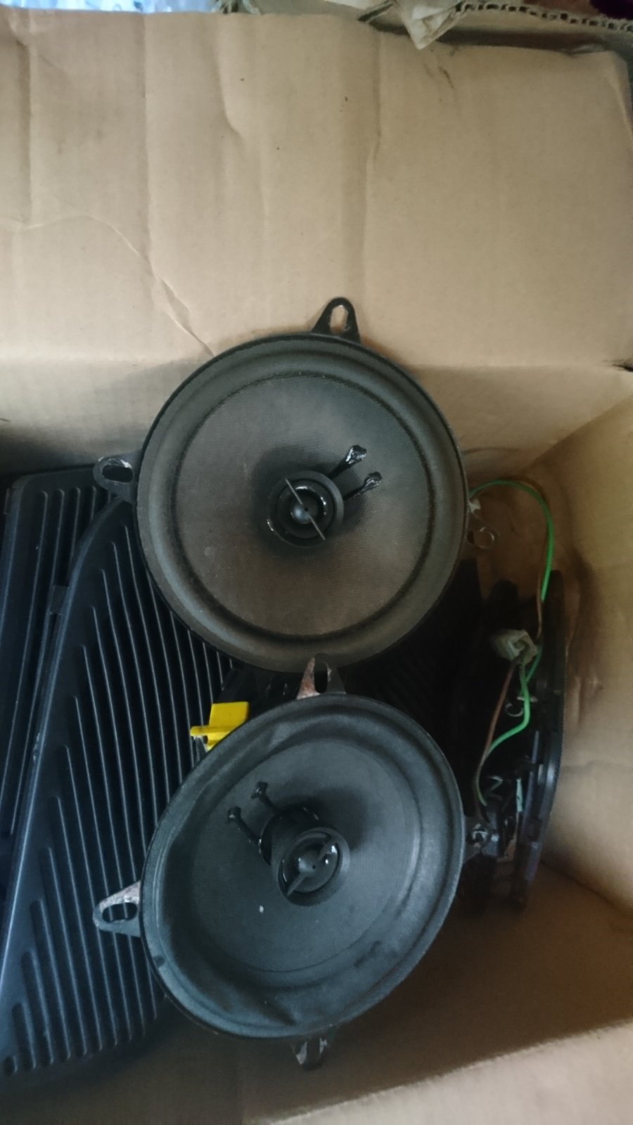

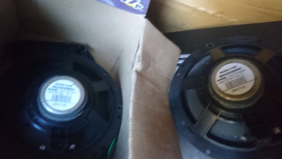

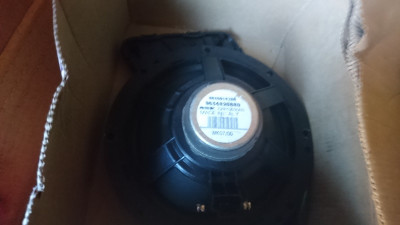

I have these from a Mk2 xantia if it helps

Re: Xantia S1 Speakers - What's a good, cheap replacement?
They look to be in good nick.
What you looking for for them please Colin?

admiral51
- Posts: 2666
- Joined: 24 May 2007, 10:11
- x 391
Just postage cost nothing more than that Roger
I am 99.9% sure i have the dash speakers also if you need them as well.
Colin

admiral51
- Posts: 2666
- x 391
If someone can check that MK1 and MK2 speakers are the same then happy to send you the complete set, i also have the grilles for i think both front and rear doors also.
Screw holes across diameter are 155mm apart (6 1/8”). They are 165mm overall to the extreme diameter and 60mm deep. That’s all I can tell you.
I ‘think’ the rears are 135mm. I say think because I offered up the new ones I’d bought that were supposed to be 6” and they look about right.
