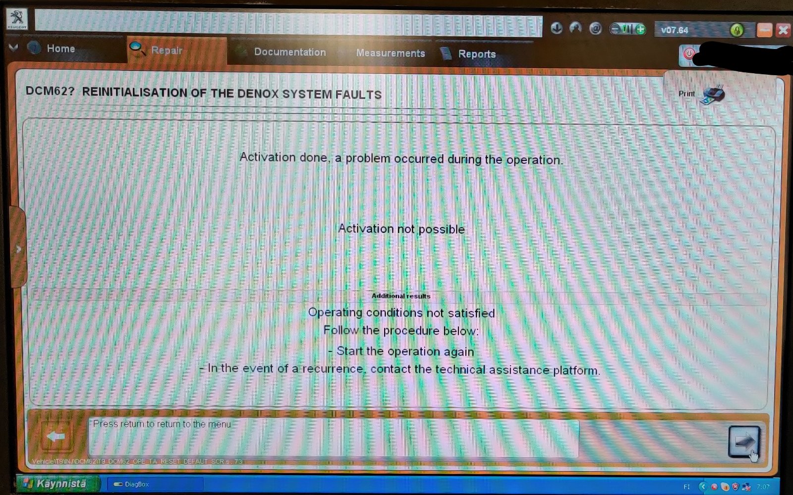

Hi all,
my first time around as a regiatered member! Have been around for quite a while searching for fixes to issues on mine or relatives frenchies.
My todays top topic is about my -15 plate T9 308 GT BlueHDi (180bhp). I bought the thing two years ago and had the Urea light emerging within the first vacation after few weeks of joy (ofcourse on vacation..). On which occasion I simply added AdBlue and kept clearing the faults which gave me mileage to finish my vacations of 2500 kilometer. At the end of vacation the urea light did vanish and stayed out of sight till last years December. By this time I knew that the reservoirs pumpunit must be at the closing end of its lifecycle and drove to work and home for two months by just doing the reinitialisation on Diagbox v7.59. I've must have done it a 8 times.or so once it finally did not work any more.
I uninstalled the system and opened the pump-unit on the reservoir. I used 9V battery to test the units pumps, solenoids and so on. Everything seemed to work and I was able to pump water out of a bottle with the 9V battery connected to the pump and solenoid valve (to stay open). Only parts which I was unable to check were the pressure sensor and the actual pressures holding membraine unit. After I had dismantled all of the parts I ran hot water through the whole system as long as the water from the inlet to the pump unit started to feel hot as well. (The reservoir had frozen still as it was -32C degrees outside). Filled the tank with 15 litres of Adblue.
After the full operation I was able to again reinitalize the DENOX system with Diagbox 7.59. After this the faults stayed away for five minutes after which the Urea light came back with CE light as well. Emission control fault and after 50km the mileage was limited to 1200km again. I decided to buy a new pump unit for the reservoir as the membrane is the part which most likely is faulty, wont hold the pressure and as the pump itself stops (pressure acquired) and this causes the P20E8 and now also P20E9.
Today I fitted the room temperature tank-unit to the vehicle with the new pump-unit from a crashed 1400km driven Citroen C5 Aircross -20. After filling it up tried to reinitalize the system with Diagbox, but it would not run the job. It says that the "Conditions not met" asks to retry and if no luck -> turn to the assistance server etc..
Is the problem in Diagbox caused by the Diagbox version being to old or what could it be? When going in to the repair menu and selecting the ECU, it says (has always said) it cannot be found, but it is still possible to access it and manually select the correct options.
I'm starting to get hopeless with this AdBlue-issue, I was almost certain that the problem was the membraine in the old pump unit but now I'm also wondering if my Diagbox is too old for the job..
Anybody has some thoughts after this longish essay?
Thanks in advance!
-J

Re: 308 T9 AdBlue reinitalisation problem on DiagBox
HI - in a nutshell - yes, you very likely need a later version of Diagbox. Probably Version 9.** now, but you can't upgrade to this version like the old DB V7. You'll need a standalone version which you'll have to pay a licence for or get a version that runs in VMware.
Sorry this is only a 2 (now 3) line response after your essay - but not sure what else I can say!
I wonder whether it's anything to do with the need to install new firmware when fitting a complete new tank. The C5 Aircross might have the new type pump. However, as you still have the old electronics (I think) I'm not sure where that leaves you.
- x 6945
We don't know what exact engines are involved here between the 2 vehicles. Are they identical engines of the same Euro standards? The Engine ECU may be different between the 2 vehicles, and may also have different software as the engine ECU determines and controls the metering of the Adblue.

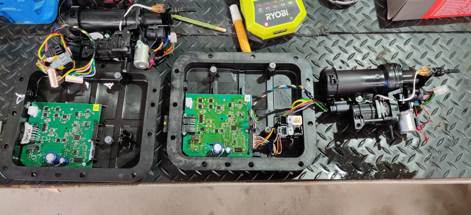

Hi all,
and thanks for the replies!
I took the pump unit off the car again and switched the elements from the new one on top of the old casing and motherboard. They look identical. I hoped this would allow me to get it reinitalized on DiagBox 7.64. No difference. I'm starting to doubt my DiagBox truly.
Has anyone tried out Würths WoW Snooper VCI/software? I looked at youtube a video on which a guy was able to run the reinitalization on Wow on a T9 BlueHDi Peugeot..?
(https://www.aliexpress.com/item/1005002 ... hweb201603_)
I'm on a bit of a dead end here.. Might try to limp to my nearest PSA dealer and try to reinitialize the system with a proper 9.xx DiagBox they are using. It just a fare bit of a drive (550km) as my range is only 700km anymore. Will get there, but if any issues on the job I wont be able to come back...
BR
-J
Hard to say whether your V7.64 software version is new enough. V7.64 was released on 20/02/2015, so may not be able to reset the system, which is why I suggested you perhaps get a standalone version of V9.** and a licence and try that first of all before you trek to the dealer which seems quite a way.

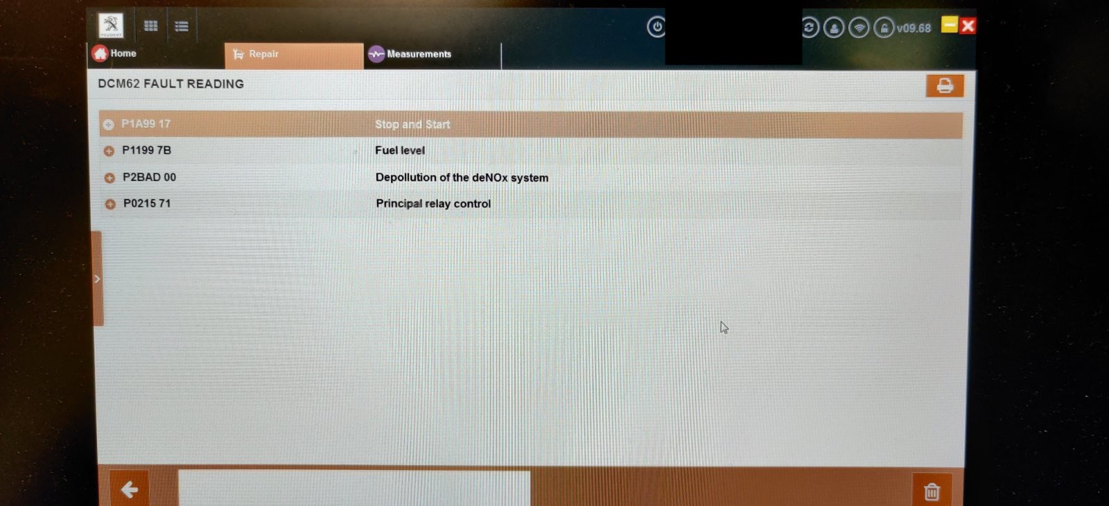

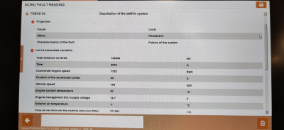

Hi all,
and replying to my own previous question "Has anyone tried out Würths WoW Snooper VCI/software? I looked at youtube a video on which a guy was able to run the reinitalization on Wow on a T9 BlueHDi Peugeot..?"
- Not possible, as WoW does not really have T9 308 option so there is no BlueHDI option on it. I think you could do it for older 1.6HDI as which has been also on mark 2. The BlueHDI option does not work under 508 either.
I got the 9.68 Diagbox and was able to connect it to my BlueHDI with my older VCI after updating it's firmware. On first five tries the software was informing again about conditions not being met when trying to run any jobs (re-initalization or pump test etc..). After this I disconnected the external charger, disconnected the additional Led bars relay-boxes fuse (XBB-relay unit - https://www.lumise.fi/lisavalot/luminal ... 050120190/). I started the engine for some minutes and continued to the part when the software guides to turn ignition on (engine not running) when carrying out the re-initialization job on Pack repair under ECU. Turned the engine off and the ignition on quickly and then pressed to re-initialize and the job went through succesfully..? After a short test drive the "Emission fault" note came back on dash with Urea-light (CE light did not appear!). Still the 9.68 is not able to clear the faults on the system. (even the intermittent ones...)
After reading the faults again the same faults were present, with only P2BAD 00 the only permanent one. Also there is one Principal relay control. Does anyone have any hints on these? I'm guessing there is still something broken in the system still after repairing the Urea fluid pressure fault etc. I'm worried it might be caused of my driving for 5000km with the emission system faulty and maybe the DPF has gotten clogged? I learned today that the BlueHDI system is quite special as the DPF is after the SCR system and thus the DPF system is somewhat linked to the functioning of SCR?
Happy to hear any new thoughts on this. Just want to get this thing sorted and I can change this diesel one to a petrol one.. (happier with my C5 2.0 HDi!)
BR
J

Hi
I don't think this is a Diagbox error to be honest, as that should easily be able to clear a 308 T9 system - I suspect it is because of the other faults you have. If these faults exist, then no amount of resetting are going to resolve the problem whilst these other errors with the system are present.
The SCR system has nothing to do with the DPF system. As you have mentioned, the injection of the Ablue is independent and injected at the Catalytic converter section, prior to the DPF. The DPF additive has a separate system independent of the SCR and each has their own dosing systems, both controlled by the ECU. The SCR is just an additional level of treatment for the NOx.
I can't help you with the P2BAD00, except to say it's generally an Excess NOx - cause unknown, but these are the fault descriptors for the other fault codes you have.
