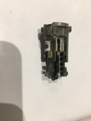

Got it largely stripped but the 3 of the 4 pins appear seized.

You dont need to put all of the pins back in, in fact you dont need to put any of the pins back in. It means it will open with any SX9 type key, no one would know the lock is blank unless there is an opportunist walking around with an SX9 key trying old Citroens.
PS you should only be able to remove the pins from the lock when it is in the rest position & the black bit fully retracted back towards the front of the lock, the position its in in the pics you posted above the pins wont come out.

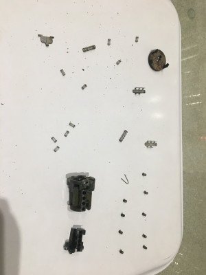

Would you believe I actually managed to remove the black sliding actuator and used light machine oil and kept working the pins. One was an absolute ...
So it sounds as though I could rebuild just using the little V shaped spring which pulls the actuator back when the key is removed.

Damned lock!
I rebuilt today with pins, no worky.
Stripped the pins out, no worky.
Put some pins back in, worky.
Stripped it back down and lubricated with graphite powder, rebuilt. No worky.
And that is with the broken tab. Those tabs cannot be bent, they are actually metal in my lock not sure if the later ones are plastic perhaps?
So!
I’ve rebuilt with a spare black metal ‘carriage’ out of another lock and noticed that when the key goes in, the carriage doesn’t appear to move 3 mm. or however much it is supposed to move.
I think the issue is actually how the black cap goes back on and whether the spring needs to be wound a certain amount?
Guidance again appreciated before I crack.

Every one i have done this repair to the tabs have been metal. When i say bend them we are only talking a little sqeeze 1-2mm max to stop the tip of the key going in too far, if the key goes in to far the pins dont align & the black bit wont pop out.
In the pic i put above is as far stripped down the lock would normally need to be, I wouldn’t normally remove the face cap like you have & im not sure what you mean by winding a spring?

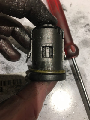

Well! Got it all back together and because I was unaware I could remove the cylinder without taking the handle out, I ended up taking two of the rods out.
The locking, deadlocking and unlocking are working (in a fashion). Locking action is a bit stiff. It just catches a little bit a wiggle helps. Nothing I cannot live with.
The rod with the serrations on that actuates the door latch is no longer working. It’s clipped in. Does it need setting in a certain location?

UPLOADED photo to show relationship of barrel outer casing and internal gubbins should anyone else wish to service their locks. May even produce a short video for posterity.
