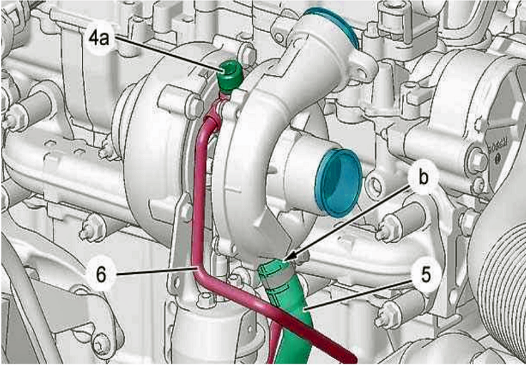

Remove:
  • The bolts (1)
  • The heat shield (2)
  • Uncouple the vacuum pipe (3) ( as "a").
Note: Keep the filling cylinder full.
Uncouple the lubrication return pipe (5) ( as "b").
Note: When slackening the unions, ensure that they do not rotate (Support them if necessary)
Remove the lubrication pipe (6), allen screws (4) and ring seals assembly.

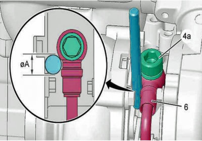

Method for tightening the upper union:
Put a ("A" = 8,5 mm) diameter pin in place vertically, as indicated above
Tighten the bolt (4a) supporting the union using the pin; Tighten to 3 ± 0,45 daN.m
Method for tightening the lower union:
Put a ("B" = 7,5 mm) diameter pin in place horizontally, as indicated above
Tighten the bolt (4b) supporting the union using the pin; Tighten to 3 ± 0,45 daN.m

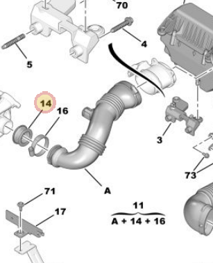

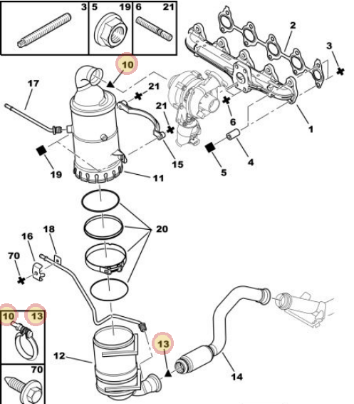

Ok, so these are the recommended parts to be replaced according to the procedure. All these are actual Peugeot part numbers, so if you ring them up directly and quote the part numbers they will know what you are wanting.
Item (72) MUL Self-Locking Nut, Part 6935A5 x 4 £4.25 each
Item (7) Copper Gasket, Part 015708 x 4 £2.47 Each
Item (14) Intake O Ring Seal, Part 144081 £2.14
Item (14) Sleeve, Part 1434C8 £20.58Item (10) Exhaust Clamp, Part 171360 £12.88
Item (13) Exhaust Clamp, Part 171377 £14.78

GiveMeABreak wrote: 23 Feb 2021, 09:58 Ok, so these are the recommended parts to be replaced according to the procedure. All these are actual Peugeot part numbers, so if you ring them up directly and quote the part numbers they will know what you are wanting.
Any chance you have a removal proceudre for the DPF please, and can the whole unit be removed in one peice rather than just taking out the insides of the unit?
EDIT------I think i see why mine wont come out now..... There are 2 bolts need undoing @19 in the last picture - i think....
