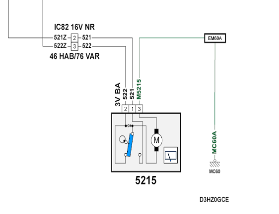

The rear wiper motor is controlled by a relay on the BSI, but I would look at the connection to the rear motor first of all:
5215 is the rear motor. Pin 3 is the earth
521: Rear windscreen wiper motor command (Pin 1)
522: rear wiper motor fixed stop control (Pin 2)
The earthing point (MC60) is on the rear tailgate located below:
So I would check the plug connections there first of all and the condition of the pins and socket for damage or water.
