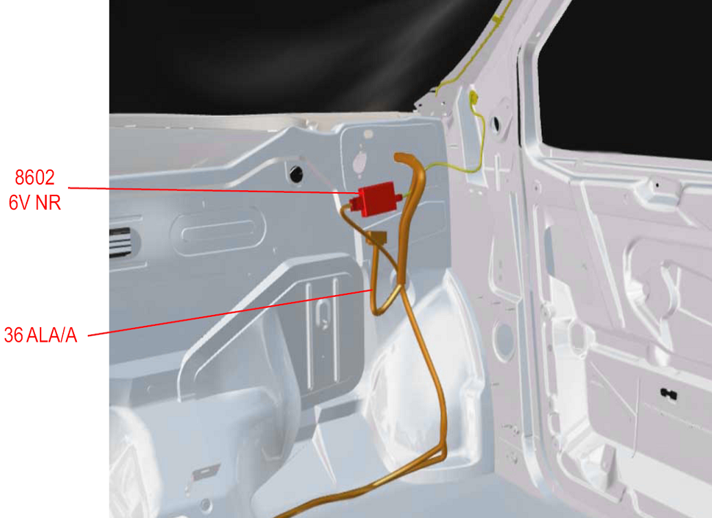

I know this is a bit late, but can you pop your VIN up - just in case it isn't fitted with one!
I've had a look at another Petrol C8 of this year and there is a unit called the interior protection unit (anti-theft alarm) - item is 8602 on this diagram - which if it's what you are looking for would appear to be here:

Right, that answers the first issue - the vehicle was not fitted with an anti theft alarm at the factory, so that's why it is not there.
Second, if you have replaced the BSI and engine ECU and the BSI was lifted straight of another vehicle, it will be configured with the options for the donor vehicle. So if your donor BSI was from a vehicle with an alarm system fitted, then the ECU will be configured as present in the donor BSI, when it is not physically installed in the vehicle. This will be one reason why it is playing up.
What you need to do is go through the BSI settings / configuration and make sure you have the correct equipment fitted for your own vehicle. Obviously, one thing you need to do is locate the Alarm section and change the option to non fitted.
