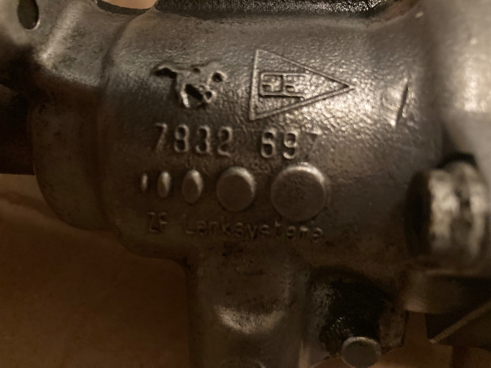

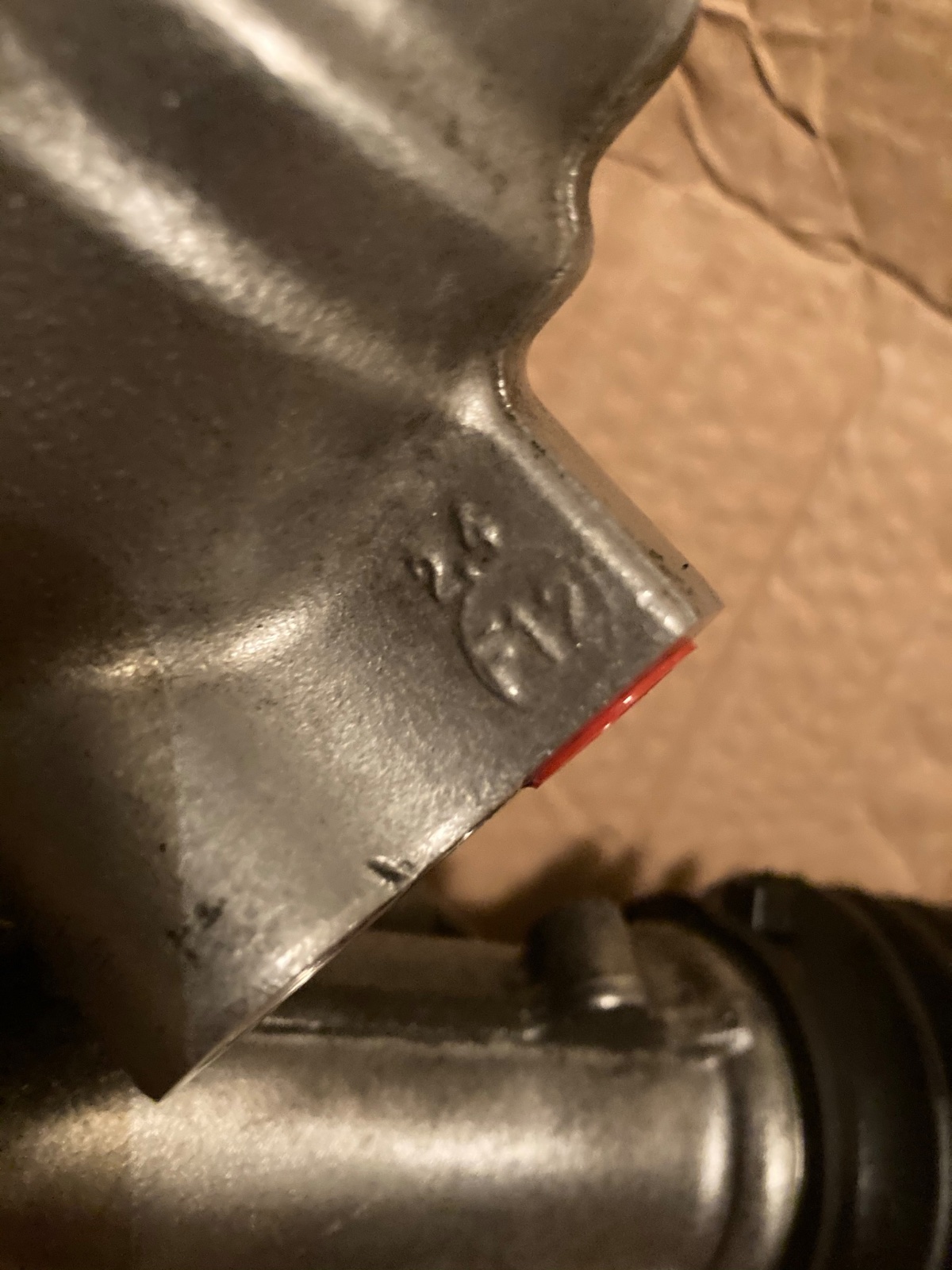

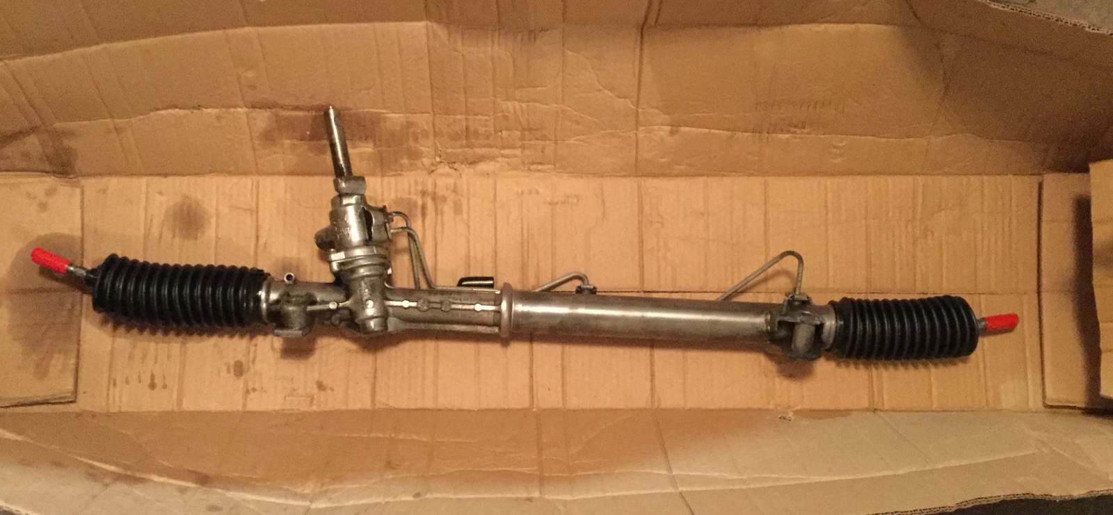

Hi Guys,
Like a lot of others I’m in the process of replacing a leaking steering rack in my C5.
I have a refurbished rack which the supplier advises is the correct one for me, however, it doesn’t have the correct matching part no (not a PSA part)
I’ll attach an image and I’d be obliged if anyone can identify if it, or if there’s any other way to confirm it’s correct before leaving it in.

Paul,
From the photo it appears right but all the racks are very similar.
What details did you pass to the supplier ?
The rack will depend on wheel size for 17",18" & 19" Citroen part no 98 014 154 80 for 16" is different can't find the part no at the moment.

I've had a quick squizz at my spare rack, and first impressions say it's the same. Certainly all the lumpy bits seem to be in the right places !

The rack may look the same and have the same part number on the body but to be sure when you have your rack off, make sure the flat on the spigot is in the same position and both tack rods are the same length, before trying to swap it.

I took a few snaps before it was fitted, maybe you might recognise the manufacturer.

Looks like an original rack and these are made by ZF.

There's a few subtle differences on your pinion casting to the one I've got here. Yours shows what appears to be a galloping dobbin above the '7832' number, whereas mine shows what looks like a stylised 'EDM'. Yours also has what looks like a '2.4 F12' cast into it (middle pic) whereas mine has nothing except a blank circle where your 'F12' is. I'm not venturing out into my shed to compare the numbers on your bottom picture though, as it's dark and cold out there
- x 1746
Re: C5 X7 Steering Rack?
Have done a quick trawl through ZF Group sites, racks, wikipedia entries, etc, and can't find any example of the stallion logo/symbol. ZF own a huge number of subsidiaries, which complicates identification. The ZF "ZF" logo is widely employed.
Casting reads ZF Lenksysteme. The logo for this is the series of enlarging circles. Looks like a joint business with Bosch.
Looking further, the 7832 697 is also a ref no for Lizarte remanufactured/replacement steerting racks for C5 etc.

The 7832 697 number is clear on my original pinion casting i.e. the one fitted to my car in 2009, as is the ZF Lenksysteme name, so I think the 7832 697 is the original casting reference number. I suppose the way it's been made is that the pinion casting is made by one company, it's then assembled by ZF Bosch, then it's supplied to PSA as a complete (substandard !) rack.
